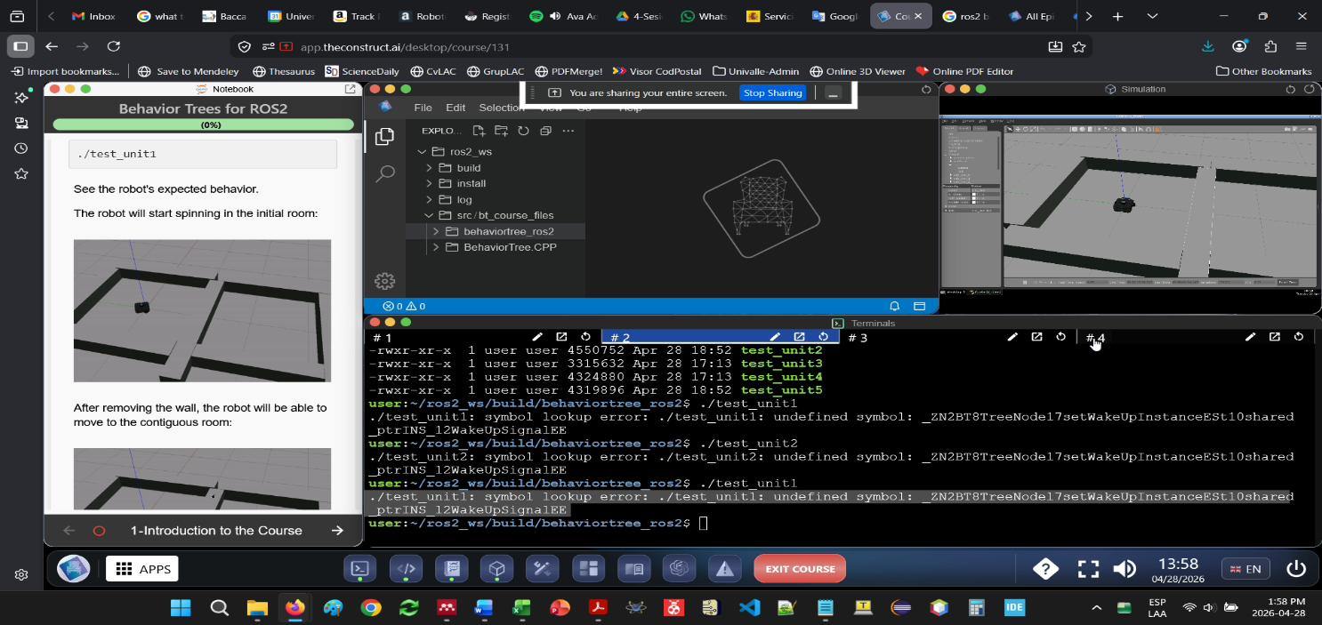

Hi, In the course Behavior Trees for ROS2, Unit 1 (INtro) There is an error:
./test_unit1: symbol lookup error: ./test_unit1: undefined symbol: _ZN2BT8TreeNode17setWakeUpInstanceESt10shared_ptrINS_12WakeUpSignalEE
Running the test_unit1 program.
Please help?

I just attempted this and it works properly. Can you confirm that you followed all the previous steps without skipping any?
If so, I would recommend removing the repository and starting from the beginning again.
thanks for your answer, but I solved it. In the guide document, after running the simulation, it is necessary to source the instal/setup.py again.
