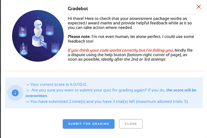

I attempted the quiz two times only please see screenshot below. Also, the name of the node is topics_quiz_node.py but the class defined in the python code is named “topics_quiz”. Should I just rename it?
My bad, that’s correct. I mistook the score for the number of trials. I apologise.
