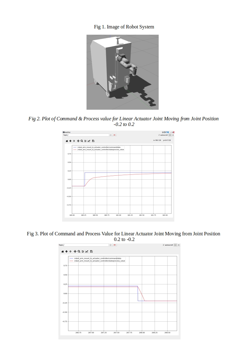

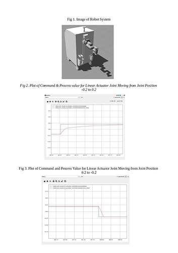

## Background
I have a lead-screw linear actuator mounted vertically on an AGV. It is powered by a Nema 17 stepper motor and moves at a constant speed of 1.5 m/minute (0.025 m/s) when stepper motor speed is set to 600 steps/minute.
## Problem
I was trying to model the linear actuator in URDF for simulation testing in gazebo. However I was struggling to figure out how to simulate the specs above. By tinkering with the PID values, I managed to get roughly the correct speed when the actuator is moving up, however, when moving down, the actuator just seems to fall rapidly in simulation.
The PID values I used were:
P: 7000
I: 1.0
D: 10.0
## Image of Robot System and Rqt\_gui Plots
 ![urdf_modelling_linear_actuator](https://get-help.theconstruct.ai/uploads/default/original/2X/3/340d23e81cb58dca5d6341422bcbf9c8fefb46c1.jpeg)
