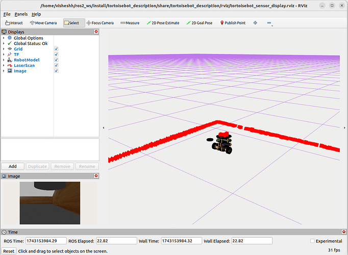

On my Ubuntu machine, I ran:
ros2 launch tortoisebot_description display.launch.py
However, instead of showing the real robot, Gazebo still launches.
Gazebo Launches
Expected Behavior:
The real robot should provide mapping data instead of launching Gazebo.
Actual Behavior:
Gazebo opens when running display.launch.py.

Thank you for your reply.
  1. The gazebo line have been removed by default and gazebo has no way of launching on the rpi ubuntu server.
  2. And i run display.launch.py on my pc which has the gazebo lines commented. So technically speaking gazebo should no open.
    Modified display.launch.py below:-
