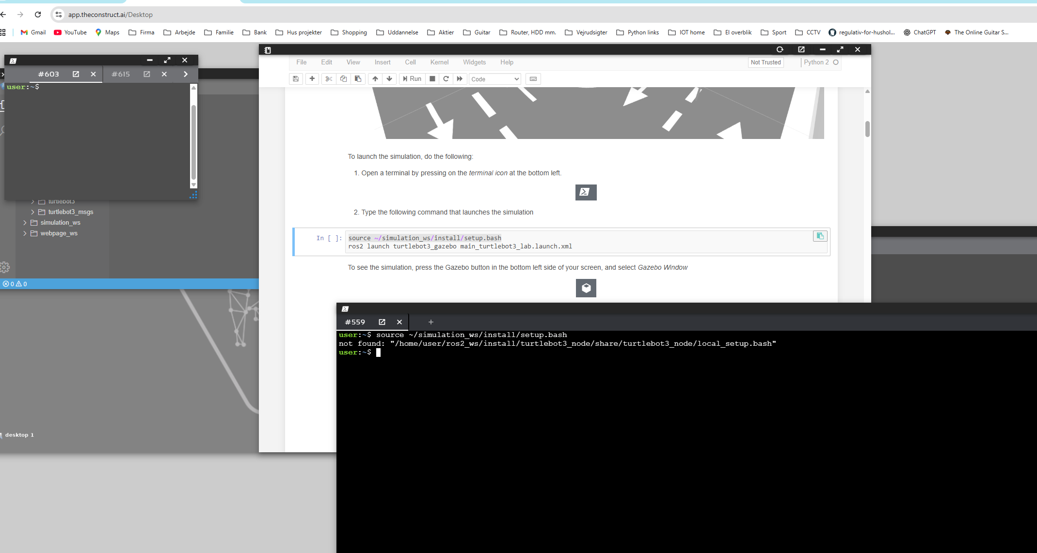

I have followed the guideline given by you, but it does not seem to work when sourcing, see below.
If I cannot source files, I am not able to do anything.
Source simulation_ws fails:
user:~$ source ~/simulation_ws/install/setup.bash
not found: "/home/user/ros2_ws/install/turtlebot3_node/share/turtlebot3_node/local_setup.bash"
Source ros_ws fail
user:~$ source ros2_ws/install/setup.bash
ROS_DISTRO was set to 'foxy' before. Please make sure that the environment does not mix paths from different distributions.
not found: "/home/user/simulation_ws/devel/local_setup.bash"
ROS_DISTRO was set to 'noetic' before. Please make sure that the environment does not mix paths from different distributions.

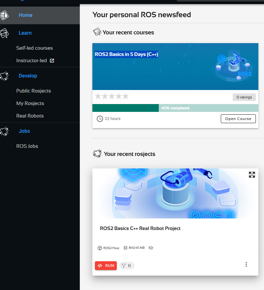

Are you talking about the Real Robot Project? I can’t find the project that you speak of. Could you please share a screenshot to clarify?
Yes it is the Real Robots project

Reason for so little information regarding the issue, is that it is all I have.
I litteraly just started the “Real Robot Project” from the GUI, and the first thing that is asked for is to run the “source ~/simulation_ws/install/setup.bash” command.
Since it failed, I don’t know what to do.
You are correct that it is the " ROS2 Basics in 5 Days (C++)" and not “ROS”, my mistake.
My goal is to just be able to start the project to go on with the course.
Let me know what more information you need? I will be happy to provide that. But as mentioned it is the first time I opened “ROSDS”, I have not altered anything:
