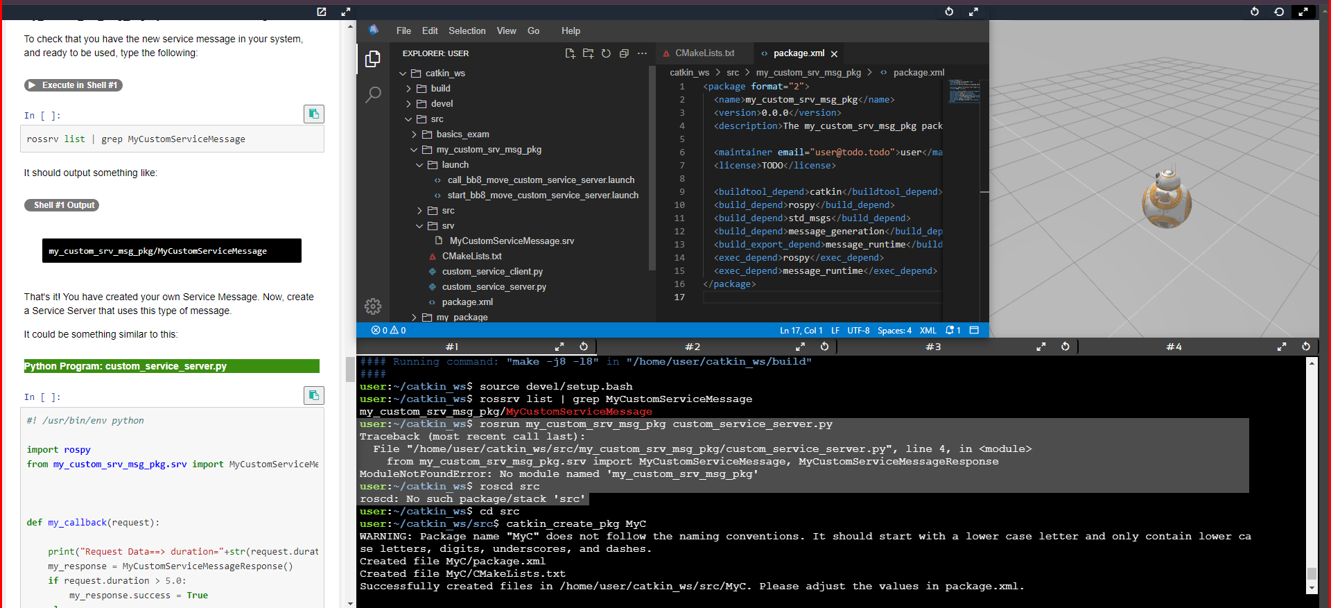

In Unit 6, both in the quiz and 6.8, I keep getting this message and the corresponding error:
user:~/catkin_ws$ rosrun my_custom_srv_msg_pkg custom_service_server.py
Traceback (most recent call last):
File “/home/user/catkin_ws/src/my_custom_srv_msg_pkg/custom_service_server.py”, line 4, in
from my_custom_srv_msg_pkg.srv import MyCustomServiceMessage, MyCustomServiceMessageResponse
ModuleNotFoundError: No module named ‘my_custom_srv_msg_pkg’
user:~/catkin_ws$ roscd src
roscd: No such package/stack ‘src’
I ran through the steps multiple times from the scratch. I am sure that I have the necessary executables, the files, correct xml and launch files.
