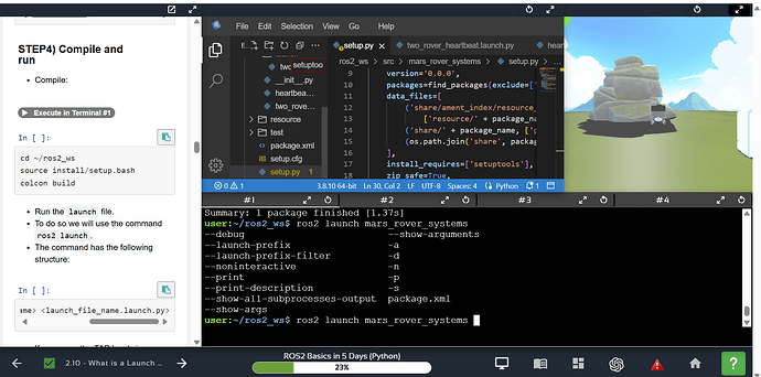

I did all the steps again, but he still says that the two_rover_heartbeat.launch.py is not a possible command.
Before running the program after compiling, you should source the terminal:
have the same problem

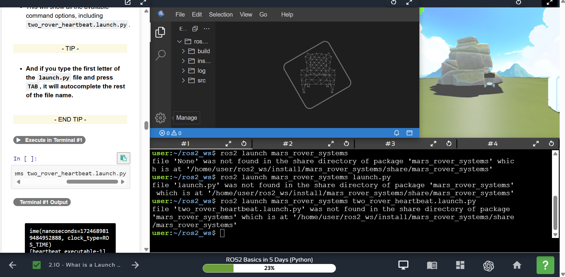

“user:~/ros2_ws$ ros2 launch mars_rover_systems two_rover_heartbeat.launch.py
file ‘two_rover_heartbeat.launch.py’ was not found in the share directory of package ‘mars_rover_systems’ which is at ‘/home/user/ros2_ws/install/mars_rover_systems/share/mars_rover_systems’”
I am having the exact same problem here. I get the error message:
file 'two_rover_heartbeat.launch.py' was not found in the share directory of package 'mars_rover_systems' which is at '/home/user/ros2_ws/install/mars_rover_systems/share/mars_rover_systems'
How do I get past this?

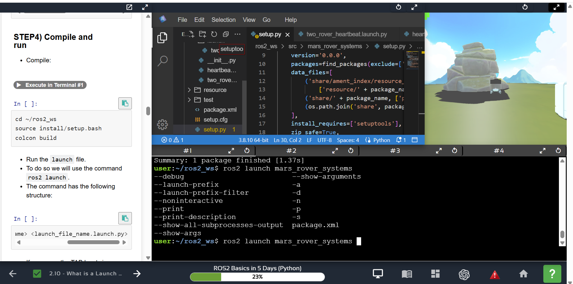

I found my problem and I wanted to put my “solution” here for posterity.
I had incorrectly created my launch directory in my <package_name>/<package_name> folder instead of the top-level directory <package_name>
