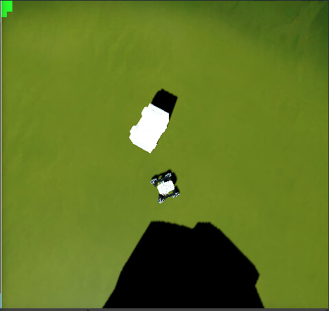

Hello,
Sadly I don’t have the same issue as batodesegun.
My simulation does respond, and I do have a green indicator at the top left of the simulation frame:
Edit: also to confirm, I have tried on two PCs across two browsers (edge and chrome).

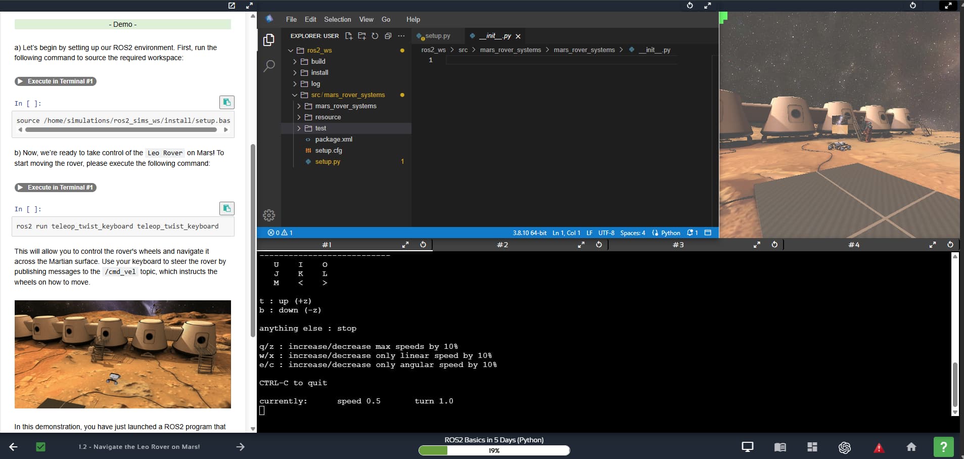

Hi, could you specify exactly the Unit and the Course you were doing exactly. Also, a Screenshot of the whole page would help because with only that image we can’t see if your window is focused, which version of the platform you are exciting this isn. Please send us that to be able to know more details on the matter

This error appears from me in all parts of section 1 of ROS for python, but the screenshot below is from:
“1.2 Navigate the Leo Rover on Mars!”.
I use a UK keyboard layout (very similar to US).
Perhaps the problem is that the terminal was NOT focused while you were trying to use the teleop program.
Focus the terminal running the teleop program by clicking on it, then press the specified keys. You should see some feedback printed.
Please let us know if this works.
Hello,
The terminal was focused while I was trying to use it. I could move the rover, however I just couldn’t move it using the keys specified. Only WSAD.

When using teleop, can you increase/decrease the speed with the q/z buttons? That’s a sign that the teleop is working.
While keeping the teleop terminal focused, press the “uio jkl m” buttons, as indicated in the attached video.
I can increase and decrease the speed, but the WSAD values work for control instead of uio jkl m,.
