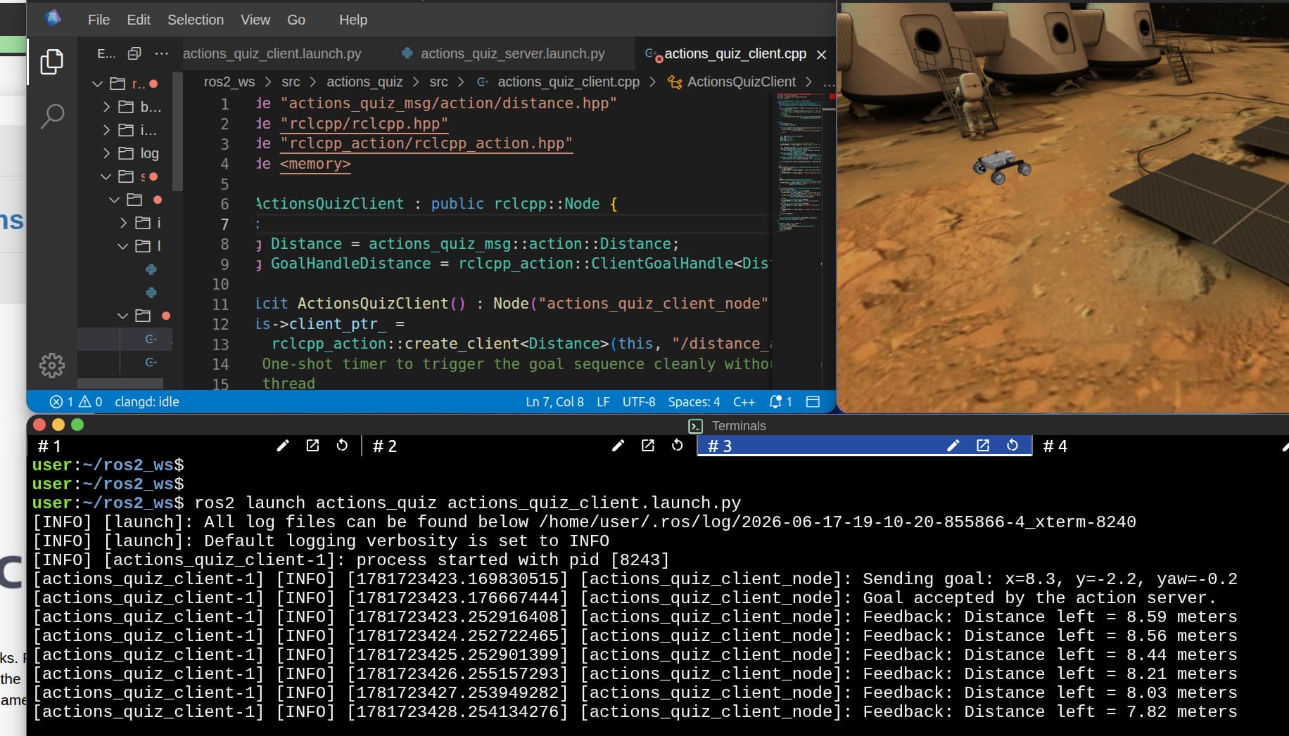

At my second attempt I got a regression in grading (from 7 to 5) with this error:
[20:15:56] [assess] Could not launch the Action Client. Ensure that actions_quiz_client.launch.py exists and is correctly configured. (mark: 5.0)
However it works locally. And it also worked for the first attempt (when I scored 7, but somehow the robot didn’t reach the destination).
This is the output of the invokation:
Here you could see the last logs and the goal completion:
[actions_quiz_client-1] [INFO] [1781723482.253604752] [actions_quiz_client_node]: Feedback: Distance left = 0.09 meters
[actions_quiz_client-1] [INFO] [1781723483.252554696] [actions_quiz_client_node]: Feedback: Distance left = 0.07 meters
[actions_quiz_client-1] [INFO] [1781723484.202673867] [actions_quiz_client_node]: Action completed with success: True
[actions_quiz_client-1] [INFO] [1781723484.202739751] [actions_quiz_client_node]: Total distance traveled: 9.63 meters
[INFO] [actions_quiz_client-1]: process has finished cleanly [pid 8243]
