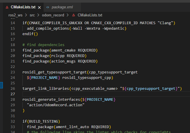

rosidl_get_typesupport_target(cpp_typesupport_target
  ${PROJECT_NAME} rosidl_typesupport_cpp)
target_link_libraries(<cpp_executable_name> "${cpp_typesupport_target}")
You also need to include rclcpp_action (for C++) or rclpy.action (for Python) as a dependency along with the other dependencies.
That should fix your issue.

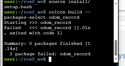

user:~/ros2_ws$ source install/setup.bash
user:~/ros2_ws$ colcon build --packages-select odom_record
Starting >>> odom_record
— stderr: odom_record
CMake Error at CMakeLists.txt:23 (rosidl_get_typesupport_target):
Unknown CMake command “rosidl_get_typesupport_target”.
Failed <<< odom_record [7.62s, exited with code 1]
Summary: 0 packages finished [8.98s]
1 package failed: odom_record
1 package had stderr output: odom_record
user:~/ros2_ws$

Hi @scklink ,
You should not add the lines that I gave you “as-is” into the CMakeLists file. It will not work.
You should replace <cpp_executable_name> with the name of your C++ executable name.
Just copy-pasting what I gave you will not work.
So just remove those two lines (that I gave you) from the CMakeLists file and just compile from scratch.
