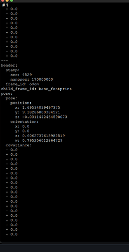

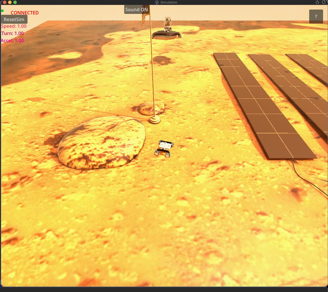

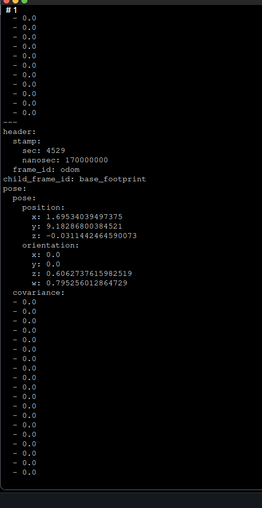

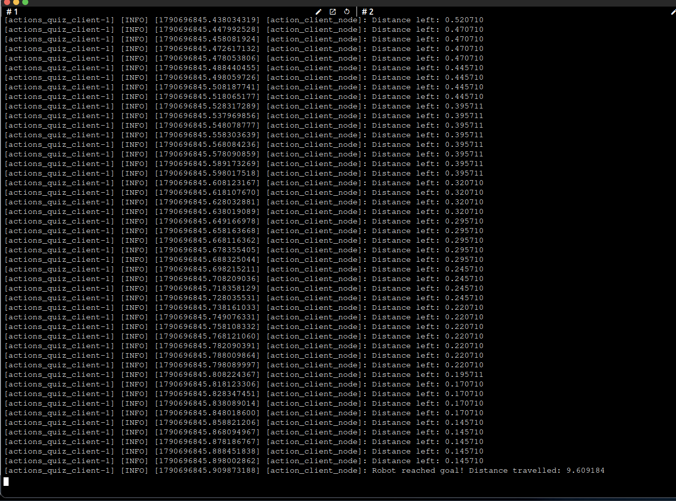

I attached 3 screenshots I took when running “locally”. The action_client_terminal file shows that feedback and final result are fine. odom_topic_echo file shows final position of the robot which is close to target. Finally, robot_final_position file shows the robot is close to flag in simulator.

I assume the expected center the flag coordinates or close to it, why it is (1.83217883110046, 8.87455081939697) ? Is because the target (8.3, -2.2) is in “map” frame and the expected center is shown in “odom” frame?
Also, seems my robot is in position (10.6248216629028, 10.286600112915) ? If that is the case, that is not even close from what I get when running locally and echoing the /odom topic, values showed in the respective screenshot.
I ran it twice, both with similar results. Do you think I could have had bad runs and should I run more times?
