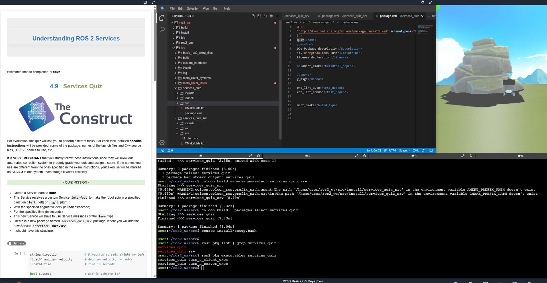

The automatic evaluation fails on “package not found” in Quiz 4.9 (Ros2 in C++ 5days) even though both packages exist (“services_quiz” and “services_quiz_srv”) and can also launch just fine. This is also visible in the screenshot shown below where the packages are correctly found in the correct path also.

Thank you for sharing that image! I can see some useful pointers therein.
  1. We have some strange files in ros2_ws/src, because you are inadvertently running colcon build in that directory. You need to run it in ros2_ws.
  2. You should be able to compile services_quiz and services_quiz_srv in one go, because services_quiz should depend on services_quiz_srv
Suggest way forward:
  1. Double-check that you have created and set up your packages properly, ensuring services_quiz has only one dependency within the workspace, services_quiz_srv, which must not depend on another package within the workspace.
  2. Remove strange files in ros2_ws/src and compile in ros2_ws. This step must pass without errors.
# Remove build files in src
cd ~/ros2_ws/src
rm -rf build/ install/ log/
# Recompile workspace
cd ~/ros2_ws
colcon build --packages-select services_quiz services_quiz_srv
source install/setup.bash
  1. Check that your packages exist and you can launch them properly. Then try to submit again.

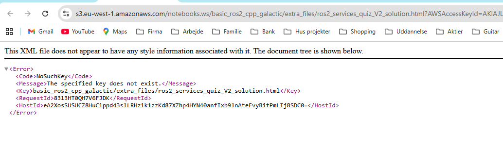

Btw. the quiz solution does not work either when pushing the button you get this:

Sorry about that. Let’s look into that.
