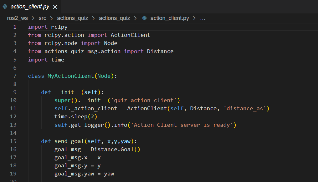

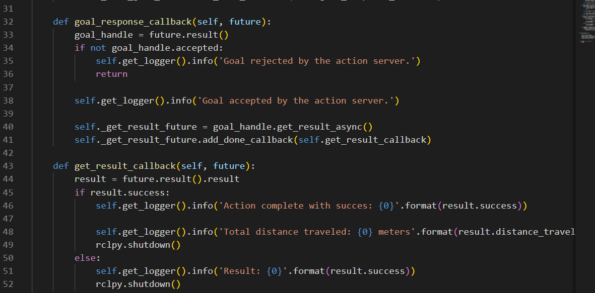

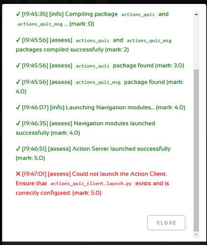

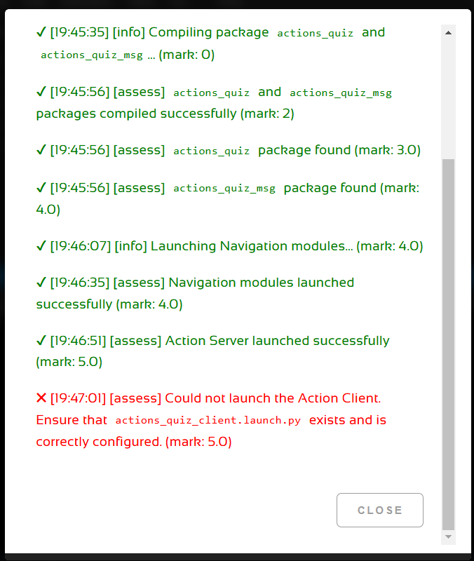

I have the action client file that i can run with the command that is provided in the notebook. But the grading bot is not able to find the file when i submit it.
[img]

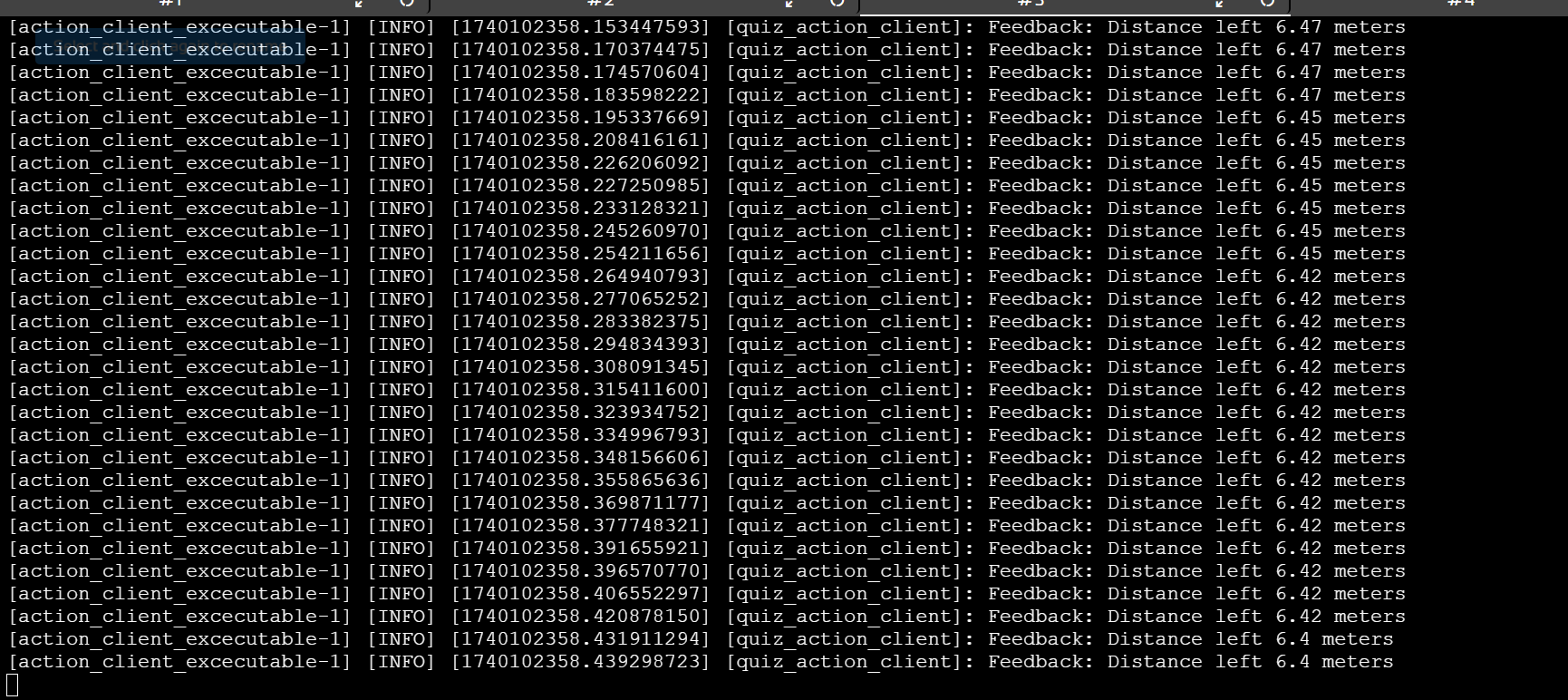

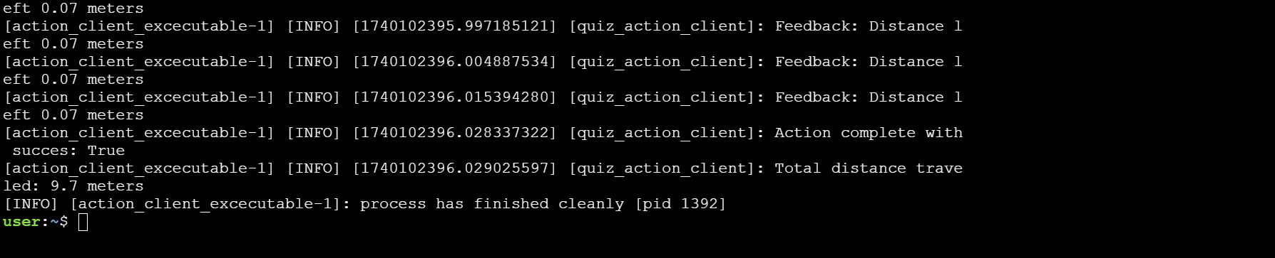

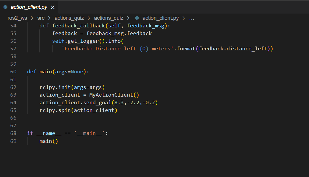

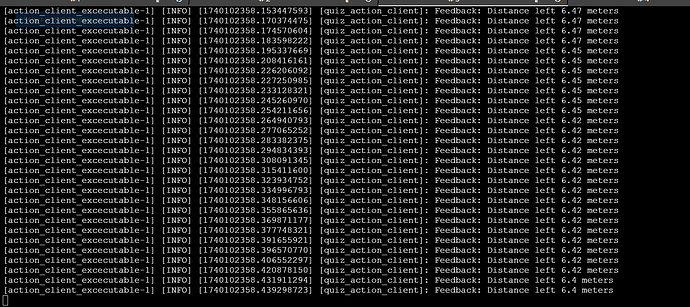

Here are some more screenshot.
The problem is that your action client exits before gradebot can check that it was successfully launched - in less than 10 seconds! Is it that fast and furious? :slight_smile:
How long does it take?
I any case, I’ve adjusted the gradebot “wait time” downwards, so please try again.

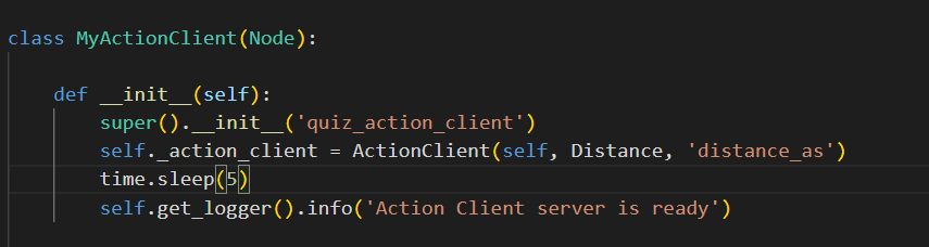

I have added a sleep function in the action client to slow down the turn on process when the init function is called. I have added 5 seconds, Do you think that will be good enough for the gradebot to find the action client? I only have 2 attempts left.
More than enough, maybe not even necessary. If your client code executes for 5 or more seconds, that should be fine.
