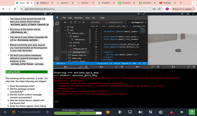

I get this same error every time I use CMake files, this happened on the quiz for unit 4 as well and because of this I haven't been able to submit either one.
Hi!
Maybe you forgot to add this line to package.xml
<member_of_group>rosidl_interface_packages</member_of_group>
The content of the file package.xml should looks like this.

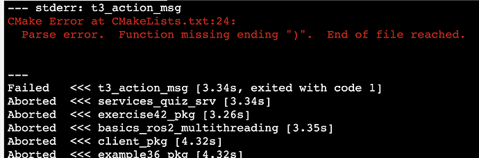

Yes, thank you! I did, but even after fixing it I get this error which is not true since there are no syntax errors there after checking the file:
Can you show me your CMakeLists.txt in package t3_action_msg?
