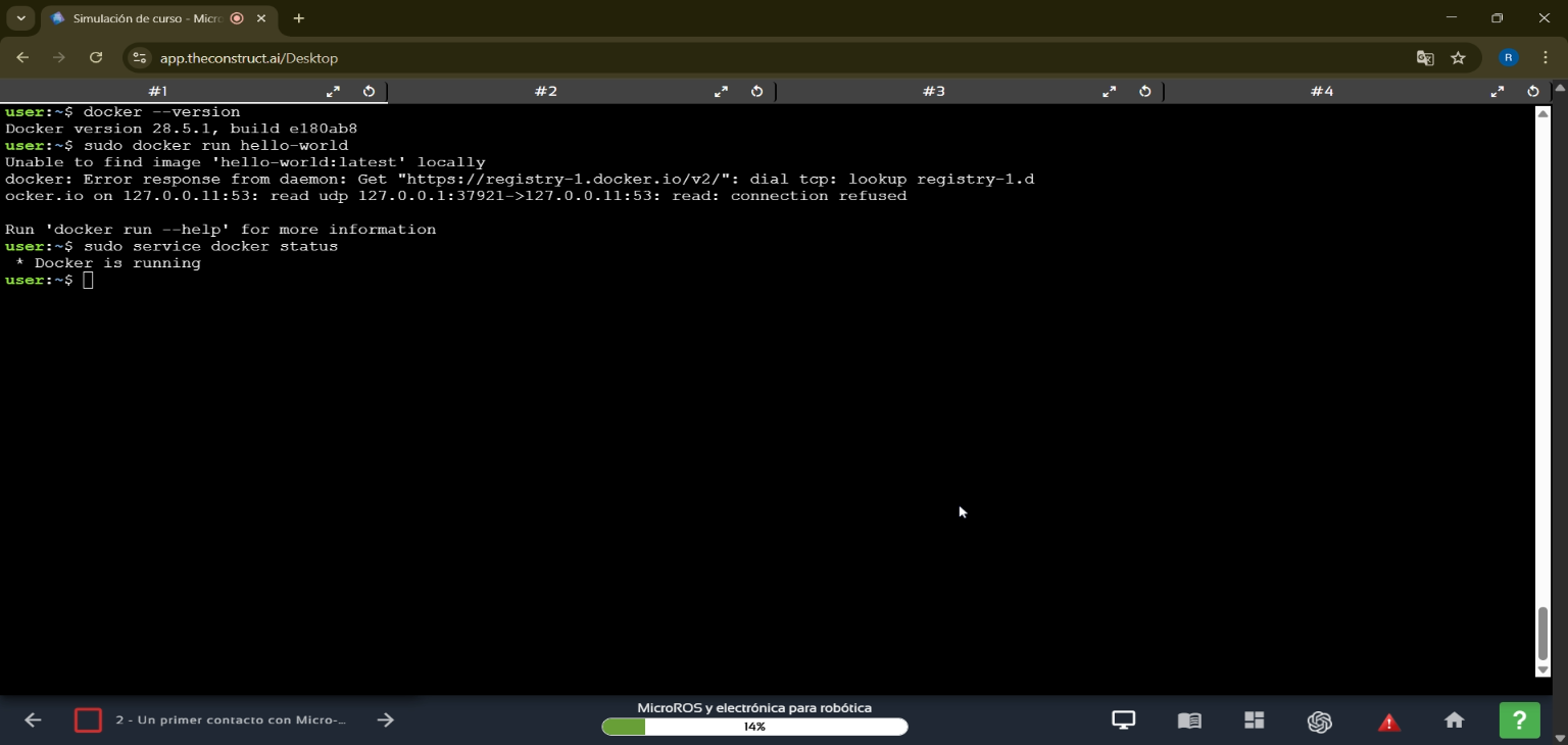

Stage 2: Current Error (DNS Failure)
After starting the daemon, the Docker client successfully connects, but the daemon now fails to resolve the DNS for the official registry when trying to pull the image.
Command & Output:
user:~$ sudo docker run hello-world
Unable to find image 'hello-world:latest' locally
docker: Error response from daemon: Get "https://registry-1.docker.io/v2/": dial tcp: lookup registry-1.docker.io on 127.0.0.11:53: read udp 127.0.0.1:47460->127.0.0.11:53: read: connection refused
I would appreciate any assistance in solving this error as quickly as possible.
