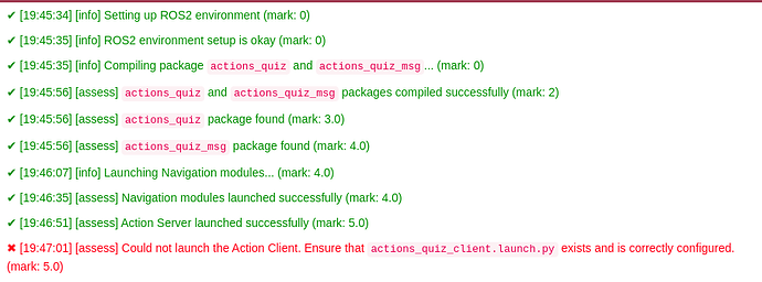

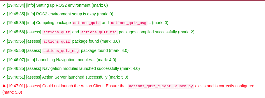

I have completed the quiz and was trying to submit it to the grading bot. I can even run the project from the commands provided in the quiz sections. But when i submit it I get a error saying that the bot cannot find the files. I have submitted the quiz 2 times, i deleted all the log build and install files when i submitted the quiz.
This was the feedback from your last submission, so the problem you reported here does not seem to exist anymore!
The current failure is that the action client exits in less than 10 seconds, so the grader couldn’t lay hold of it. That’s fast and furious!
# scrubbed - not need
I have included all file associated with Action Client. What should i do ?
Ensure your action client takes longer than 10 seconds to finish. Slow things down a bit.
