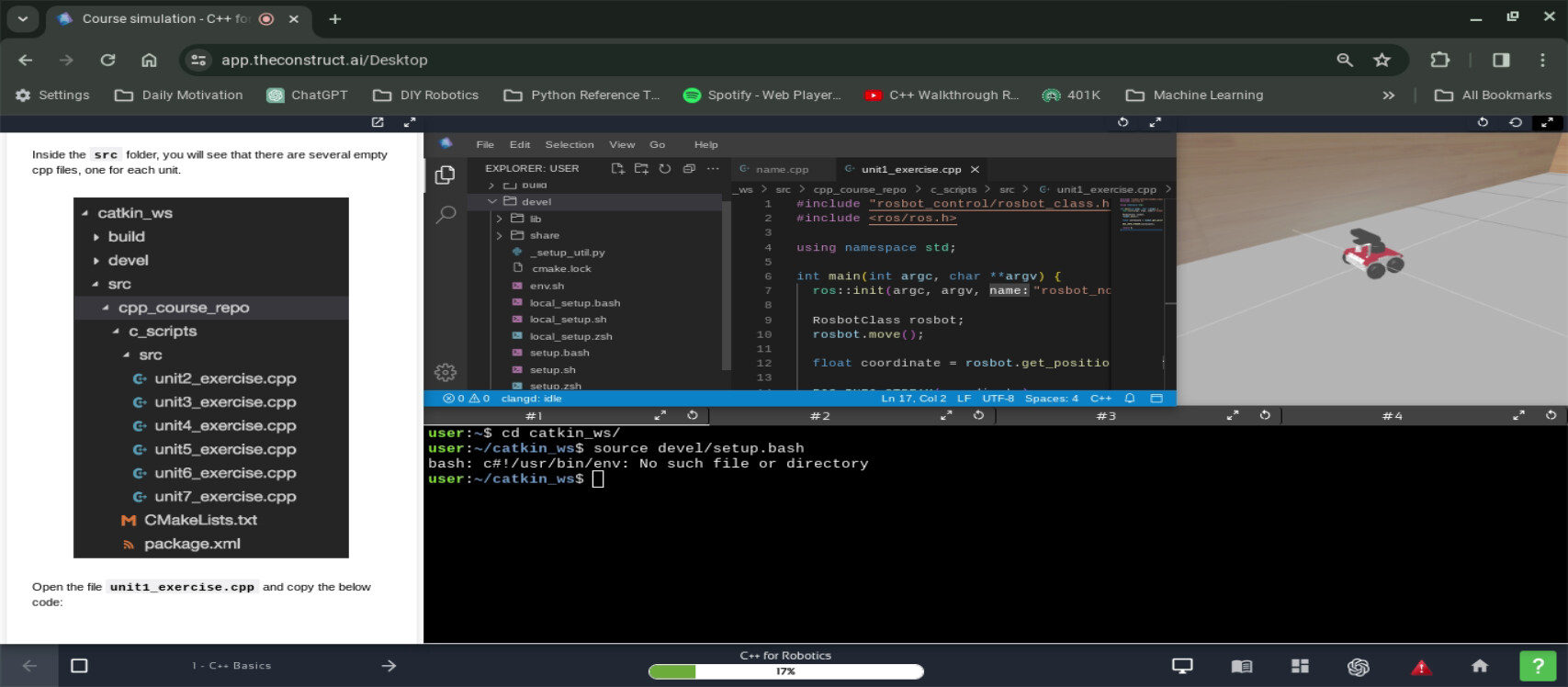

The instructions say to source the workspace after compiling it. When I copy the code from the notebook and enter it into the Linux shell I get a file not found error when clearly the file is in the directory.
Some code are not meant to be pasted in the shell; they should be pasted in a file in the IDE. I see you have pasted some “wrong” text into the shell (#!/usr/bin/env, which should go into a file).
