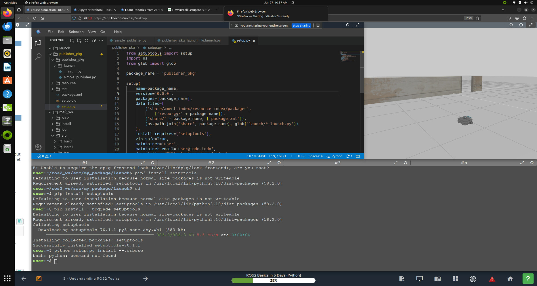

I tried to install it but still not working, what is the solve of this issue?
Hi @wisam-kakooz ,
You don’t have to run the python setup.py install --verbose command with ROS2.
To install your package that you built with python, you just need to run colcon build command.
This is not an error concerning ROS2.
Regards,
Girish
i tried to do that, but it’s not working the ros2 run ( not working), and the setuptools lib have an issue too.
and thank you
ros2 launch publisher_pkg publisher_pkg_launch_file.launch.py
Package ‘publisher_pkg’ not found: “package ‘publisher_pkg’ not found, searching: [‘/home/simulations/ros2_sims_ws/install/turtlebot3’, ‘/home/simulations/ros2_sims_ws/install/turtlebot3_teleop’, ‘/home/simulations/ros2_sims_ws/install/turtlebot3_simulations’, ‘/home/simulations/ros2_sims_ws/install/turtlebot3_navigation2’, ‘/home/simulations/ros2_sims_ws/install/turtlebot3_example’, ‘/home/simulations/ros2_sims_ws/install/turtlebot3_msgs’, ‘/home/simulations/ros2_sims_ws/install/turtlebot3_gazebo’, ‘/home/simulations/ros2_sims_ws/install/turtlebot3_bringup’, ‘/home/simulations/ros2_sims_ws/install/turtlebot3_description’, ‘/home/simulations/ros2_sims_ws/install/turtlebot3_cartographer’, ‘/home/simulations/ros2_sims_ws/install/turtlebot3_as’, ‘/home/simulations/ros2_sims_ws/install/t3_action_msg’, ‘/home/simulations/ros2_sims_ws/install/services_pkg’, ‘/home/simulations/ros2_sims_ws/install/dynamixel_sdk’, ‘/home/user/ros2_ws/install/my_package’, ‘/opt/ros/humble’]”
You need to carefully follow the examples for creating a ros2 python package. The error message indicates that it cannot find the publisher_pkg package, and that means it has not been properly created and set tup.
