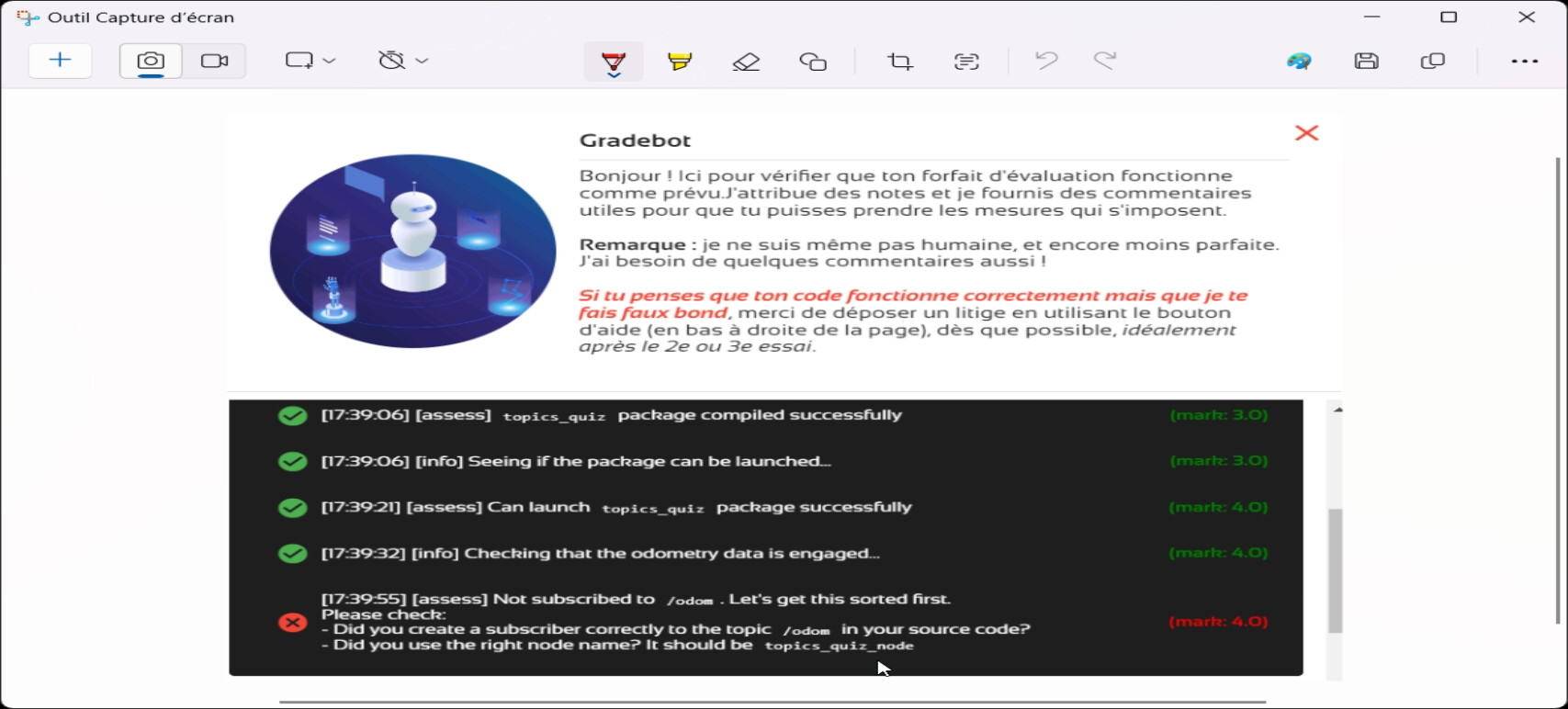

This is an error report.
Screenshot of the error
Error details
Gradebot show an error of non subscription for /odom topic but it's done in the code. When I did the second trial, Gradebot say that it was good and give me 8/10 notation. The simulation works very well.
This was not a gradebot mistake. It could be an error in our code or yours, but the gradebot is kinda perfect :wink:
That said, the first error here is that you should have contacted us after the 3rd trial max; now you have used up all 5 trials! :face_with_diagonal_mouth: I have assigned you two more trials; please use them judiciously.
The problem was that you introduced one or more errors in your code after the 2nd trial. You should re-test your code after every change to ensure it still works.
You should ensure you can launch this code for at least 30 seconds: it’s crashing with the following error:

[topics_quiz-1]   File "/home/user/ros2_ws/install/topics_quiz/lib/python3.10/site-packages/topics_quiz/topics_quiz.py", line 115, in motion
[topics_quiz-1]     if self.laser_left < 5:
[topics_quiz-1] AttributeError: 'Topics_quiz' object has no attribute 'laser_left'
