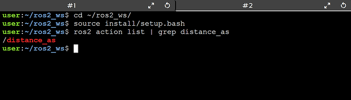

After starting the actions_quiz_server
, given below is the output from a second terminal.
user:~$ cd ~/ros2_ws/user:~/ros2_ws$ source install/setup.bash
user:~/ros2_ws$ ros2 action list | grep distance_as
/distance_as
user:~/ros2_ws$
It looks like the action server can be found.

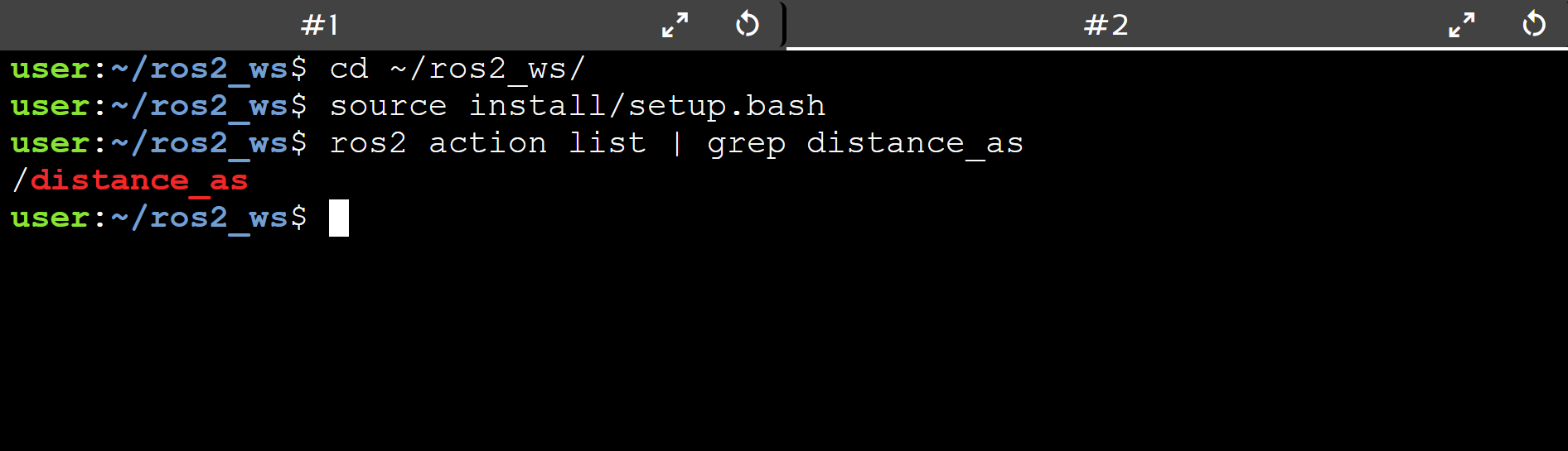

In a new terminal, I also checked to see whether /distance_as
shows up.
Given below is the output:
Everything seems to be fine, I’ll try submitting again.

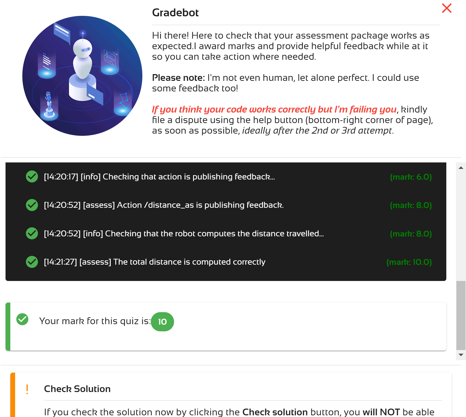

Yay!
The Gradebot was able to detect /distance_as

If you did not modify the packages after creating this post, perhaps it’s “one of those things” that usually happen when computers report a problem that’s not there .
Thank you!!
That makes sense. I didn’t make any changes to any of the packages, this time it was indeed “one of those things”
Thank you so much for your time and assistance. I really appreatiate it!
