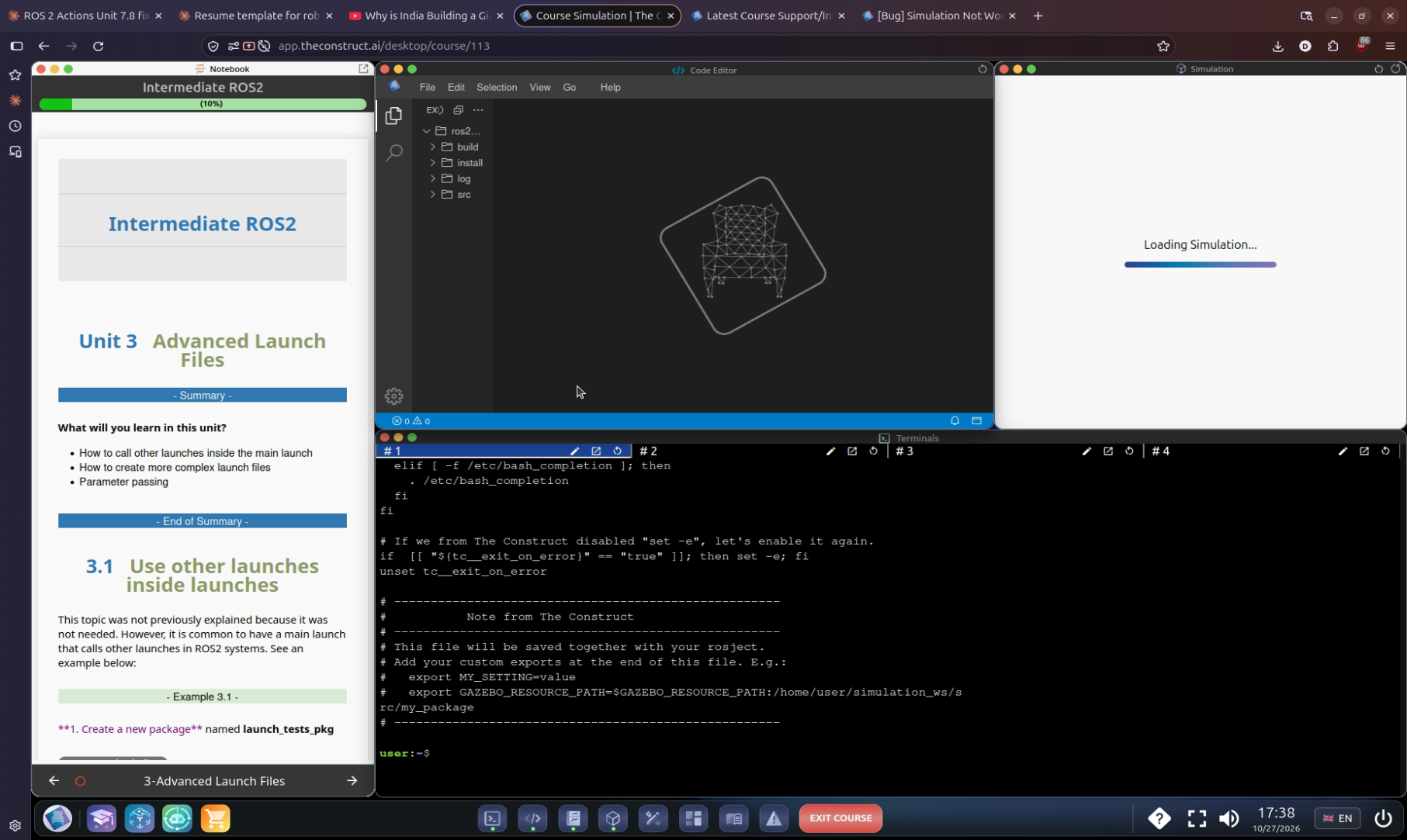

[Bug] Intermediate ROS2: simulation stuck on loading
The simulation window in Intermediate ROS2 never finishes loading. It stays on "Loading Simulation..." indefinitely (screenshot attached). The notebook, code editor and terminals all work.
What I already tried:
  • Waited 20+ minutes
  • Reloaded the simulation panel
  • Exited and reopened the course
  • Switched to a different network
  • Disabled uBlock Origin for app.theconstruct.ai and reloaded
  • Checked ~/.bashrc: unmodified (default file, nothing added after The Construct's note)
The simulation in "ROS2 Basics in 5 Days (Python)" loads fine with the same browser and network (Firefox), so it seems specific to this course's environment.
Same symptom as the closed Nov 2024 thread "[Bug] Simulation Not Working" in the Intermediate ROS2 category.
