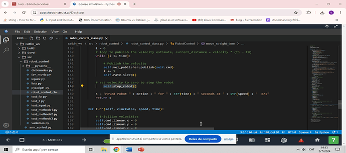

[Bug] Line 148 needs to be de-indented
Dear Teammates at The Construct.

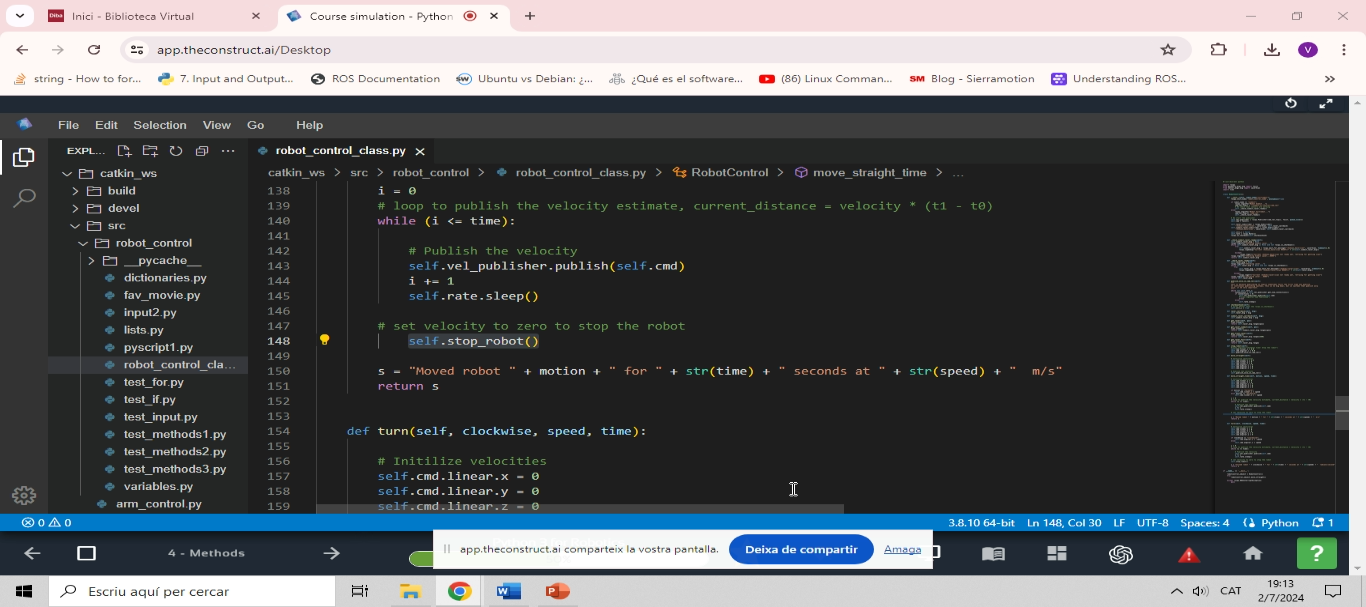

Please be kind enough to check whether Line 148 at the "robot_control_class.py" Module ("Introduction to PYTHON" Course) needs to be de-indented since, as per my best understanding, the current indentation of the stop_robot() Method regrettably hampers the "Summit" robot to move forward when requested.
As I just have successfully checked, on de-indenting said line, the stop_robot() method is taken out of the while() loop just sitting above… thus enabling the effective movement of the robot.
