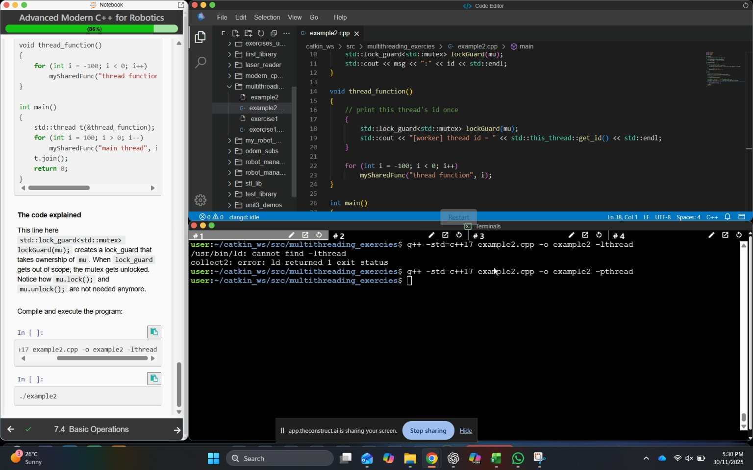

-lthread not working, needs to be replaced by -pthread

Many thanks for reporting the issue. We will update the course notebooks to use the pthread flag instead of the obsolete lthread.
