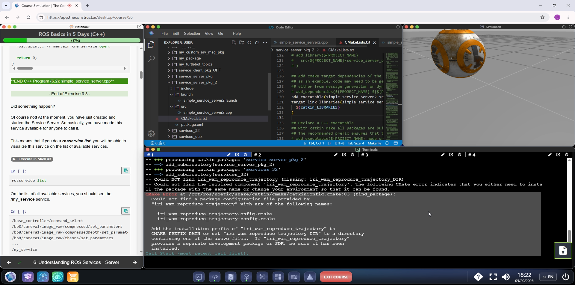

There are errors from some packages in the Simulation Environment, not my packages. In fact, I can't compile my packages due to these errors
Please remove (or comment out) references to the missing packages in your package and recompile:
cd ~/cakin_ws
rm -rf build/ devel/
catkin_make
source devel/setup.bash
