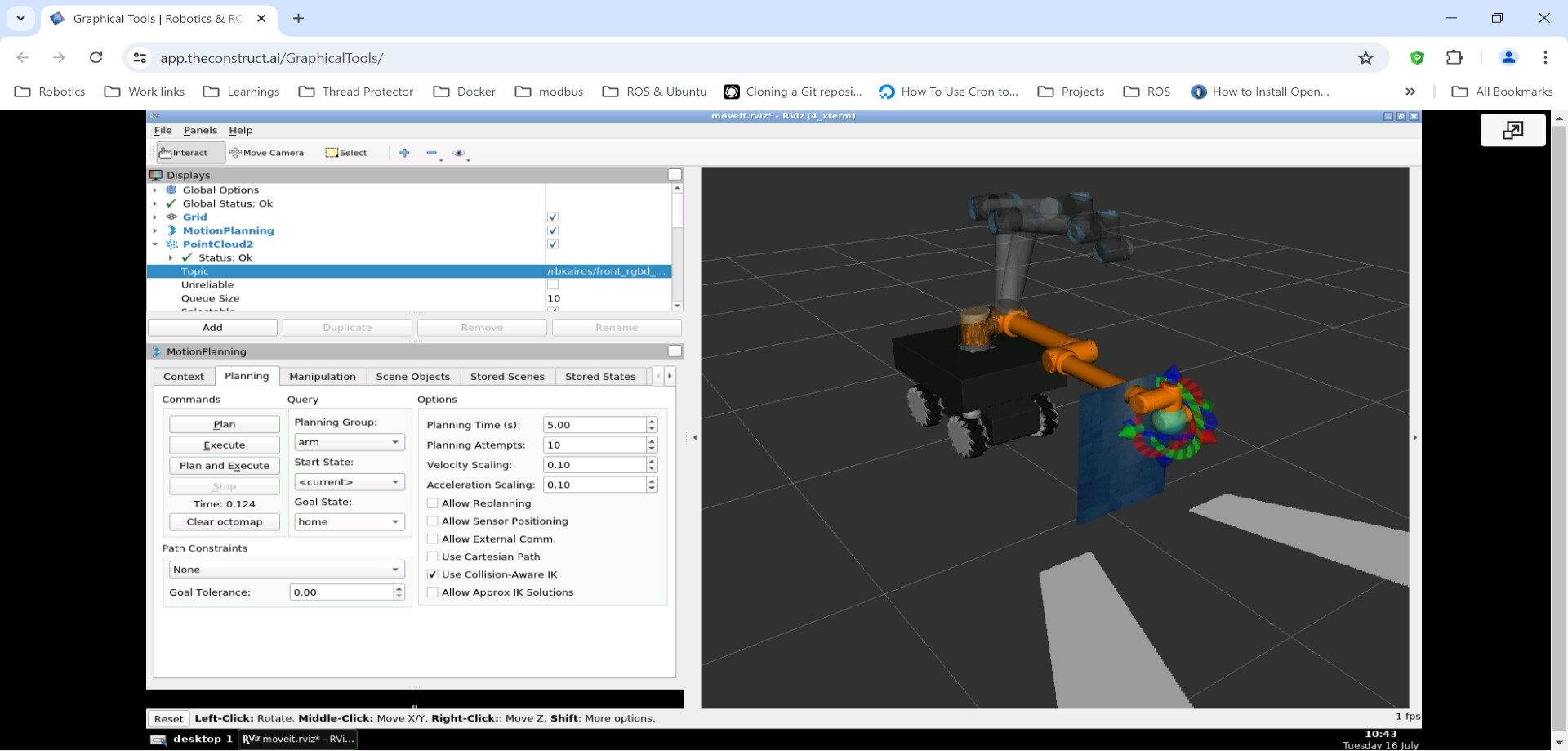

Screenshot of the error
Error details
The point cloud visual not showing gradual color change and collision detection as per unit 4.3
This is an error report.
Error details

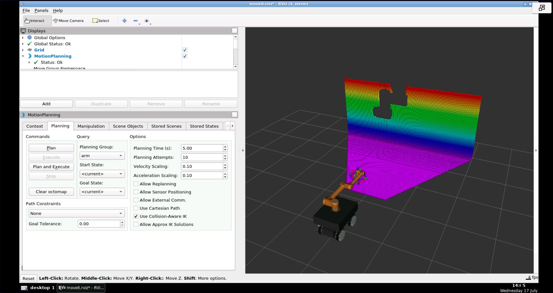

Hi @themba.ramokoka ,

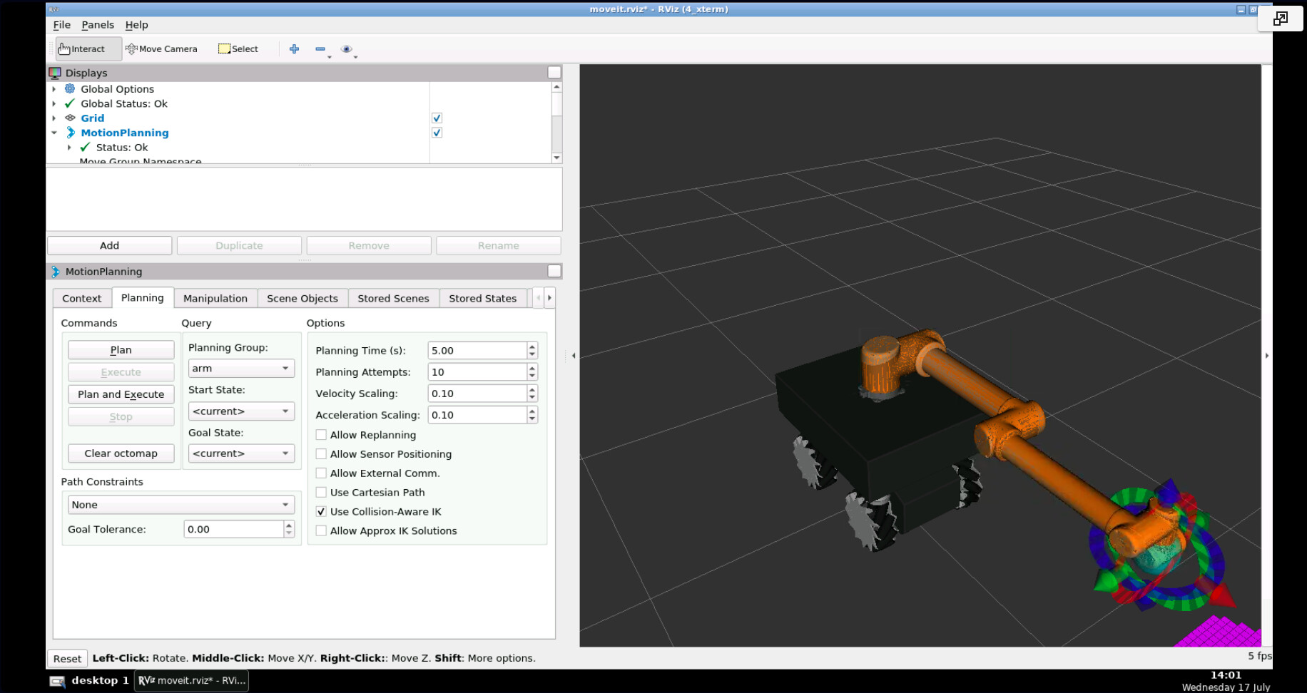

If you have configured Perception for the RB Kairos robot as per instructions in Chapter 3 in sub-section “Set Up Perception”, then when you launch the RB Kairos robot with the following command in Chapter 4, Sub-section 4.3, you should see RViz load up as shown in the first image below:
roslaunch rbkairos_moveit_config rbkairos_planning_execution.launch
Then, if you rotate the view on RViz, you will see the colored pointcloud blocks on RViz, as shown in the below picture:
You will then be able to visualize the gradual color change in the pointclouds.
If you do not get the multi-colored pointcloud data, then the only issue you might be having is that you may have ignored / neglected the perception configuration step for the robot in the previous chapter or you may have configured it incorrectly. Please re-do the steps in the previous chapter to fix this issue. That should definitely solve your issue.
Let me know if you still have any issues after following the above steps.
