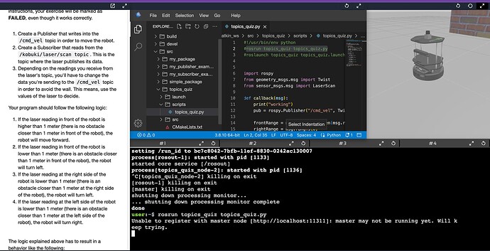

I tried logging out but the error is still there, and since I’m using ROS1 when i try rostopic list I get an error message saying ERROR: Unable to communicate with master!
I’m trying to do ROS basics in 5 days, the 5th chapter and whenever I try using any rosrun command the simulation does not run for all exercises.

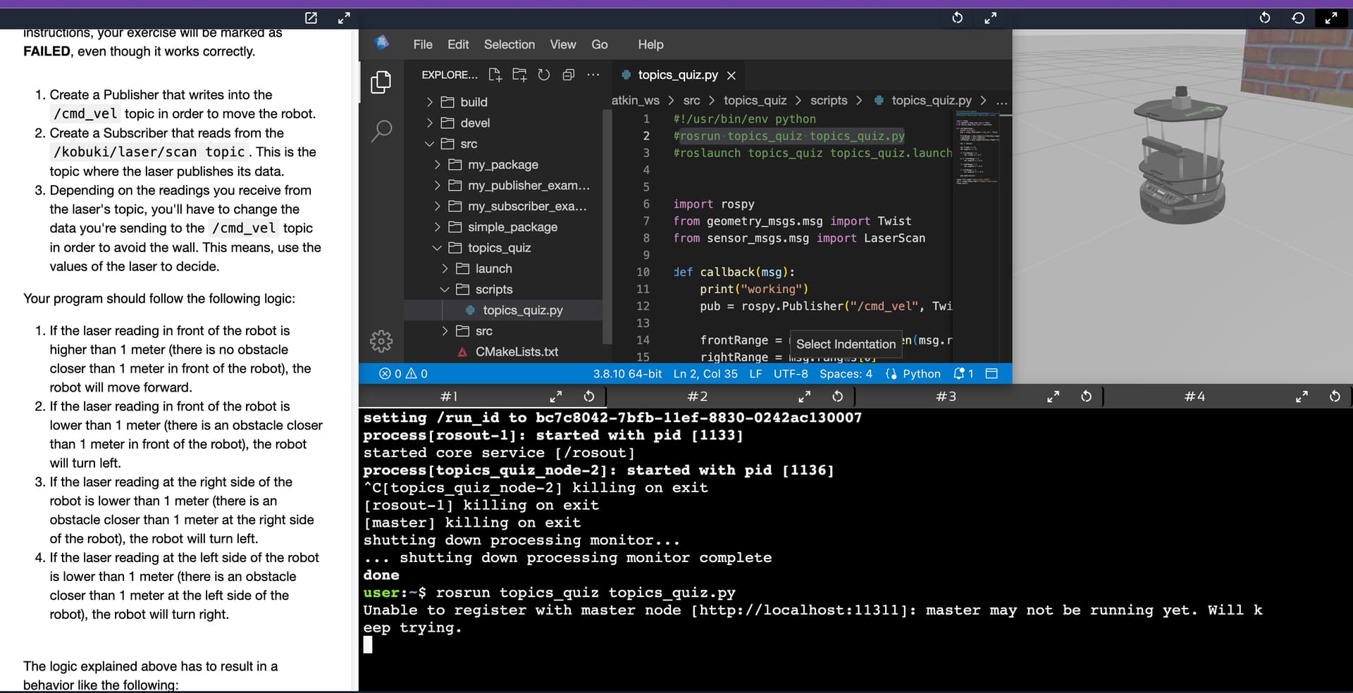

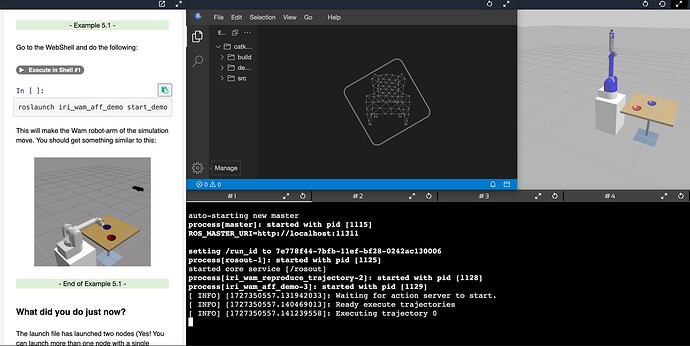

In this exercise the simulation does not work as its supposed to.

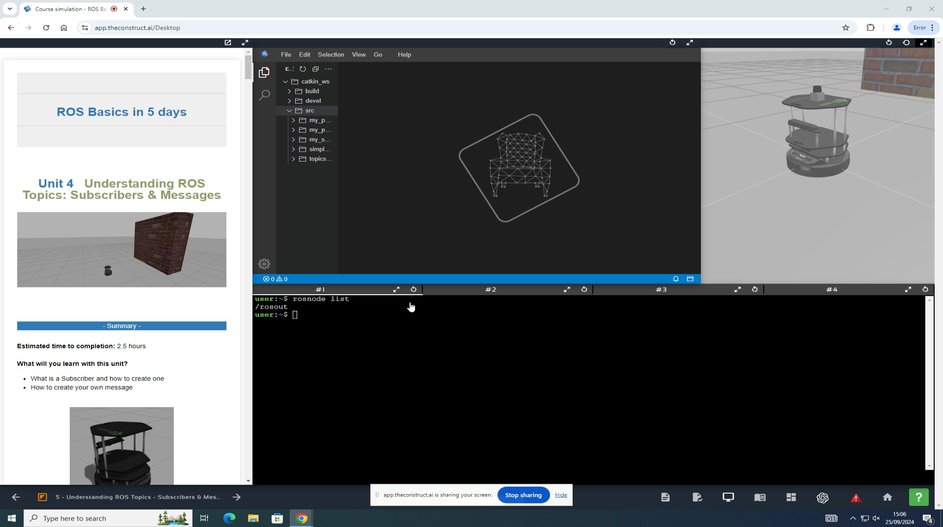

/gazebo is not present in in the rosnode list
when running this command I get this error and simulation does not run as it did before and all exercise that worked before does not work now
