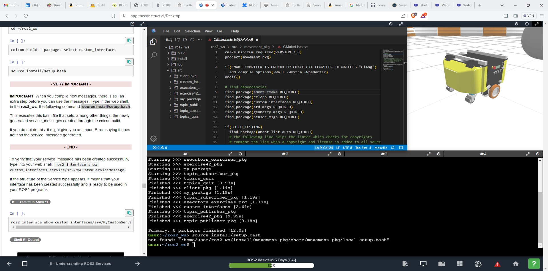

"source install/setup.bash" command doesn't work. it keeps displaying this error. i have logged in and out and still get this error.
"not found:/home/user/ros2_ws/install/movement_pkg/..."

I think you are building only the custon_interfaces package. Run “colcon build” command and then try again
Hi @abdulbasityekeen61 ,
This is a common error in ROS2. The fix is very simple, to compile the workspace from scratch.
Use the following commands:
cd ~/ros2_ws
rm -rf ./build ./install ./log
colcon build
After executing the above 4 commands, you should be able to launch your desired ROS2 program without any issue.
Let me know if this did not solve your issue.
