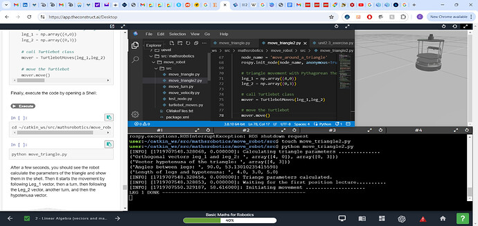

I have tried my move_triangle.py program and the solution to the problem given by the course and both result in the Turtlebot getting stuck in an endless rotation after the first leg.

Hello @coltonewestern ,
Many thanks for reporting this error. The exercise code has been updated and it should work OK now.
