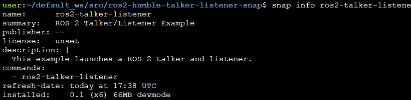

the snap was created and installed, i can even see the info of it but at the moment I try to execute it i got a response Permision Denied
sudo snap install ros2-talker-listener_0.1_amd64.snap --devmode
ros2-talker-listener 0.1 installed
user:~/default_ws/src/ros2-humble-talker-listener-snap$ ros2-talker-listener
cannot create cgroup hierarchy /sys/fs/cgroup/freezer/snap.ros2-talker-listener: Permission denied
imagen
