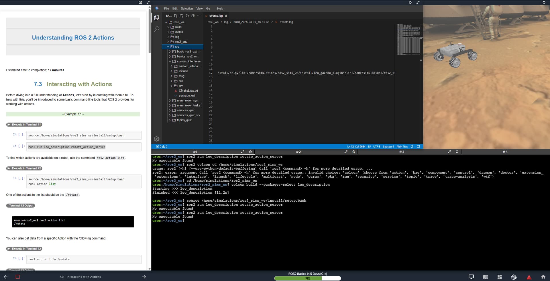

It cannot find rotate_action_server executable.
Following instructions:
source /home/simulations/ros2_sims_ws/install/setup.bash
ros2 run leo_description rotate_action_server
It does not work. See screenshot.
Hi @soren.rusbjerg , it has to be ros2 run leo_description rotate_action_server.py. There is a typo. We will get it fixed. Thanks.
It works. I was looking for the folder for this script but the folder is not visible from the ws so I could not see if the name was wrong etc.
