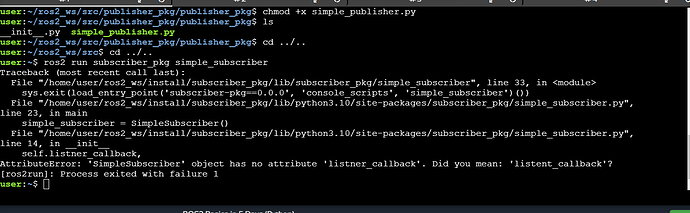

I have compared the file line by line to the example and I cannot see my error . How do I read this message.

Your program seems to be fine. The error that you posted in your image seems to show a typo in your function name.
The error states that SimpleSubscriber has no attribute listner_callback.

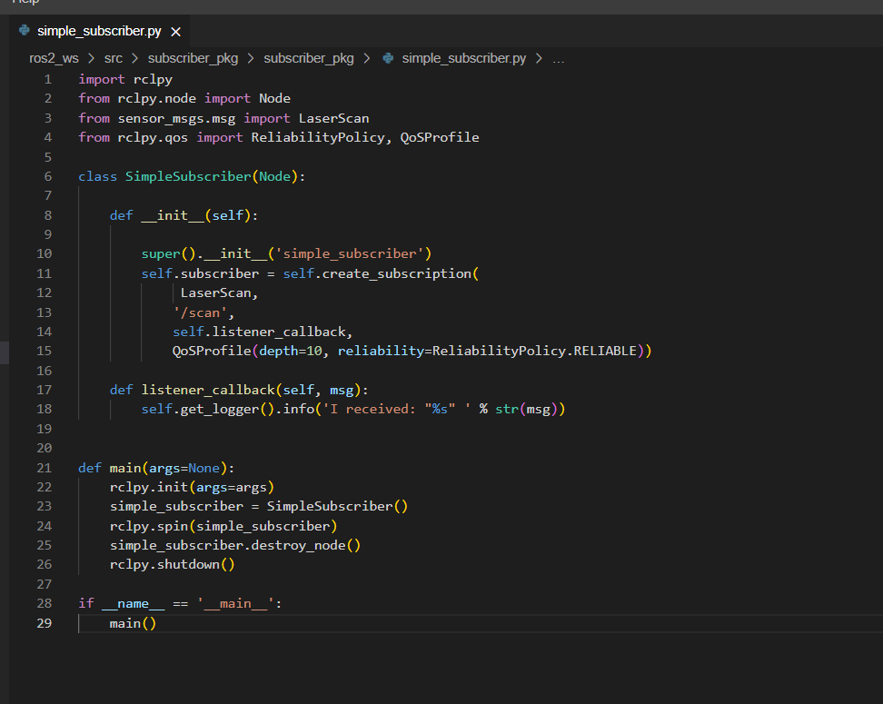

But your code in the second post seems to have fixed the typo error by actually having the function name as listener_callback.
I believe the install packages have not updated since your past build.
You need to build from scratch to fix this issue.
cd ~/ros2_ws
rm -rf ./build ./install ./log
colcon build
source install/setup.bash
Then run your program executable:
ros2 run subscriber_pkg simple_subscriber
This should fix your problem. Let me know if this did not work.
