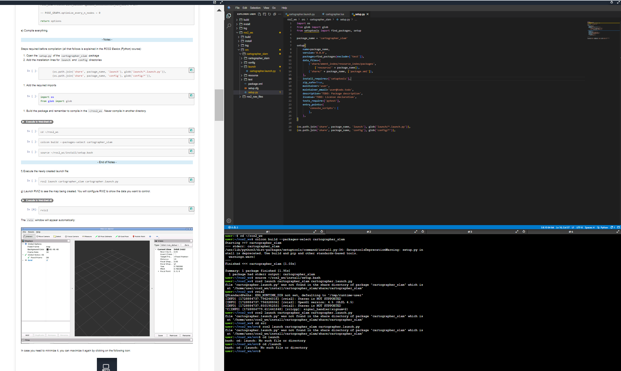

It is here, and i updated it as per the instructions but still got the same error
In the setup.py … at line 11,
Code should look something like this:
data_files=[
    ('share/ament_index/resource_index/packages',
        ['resource/' + package_name]),
    ('share/' + package_name, ['package.xml']),
     (os.path.join('share', package_name), glob('launch/*.launch.py'))

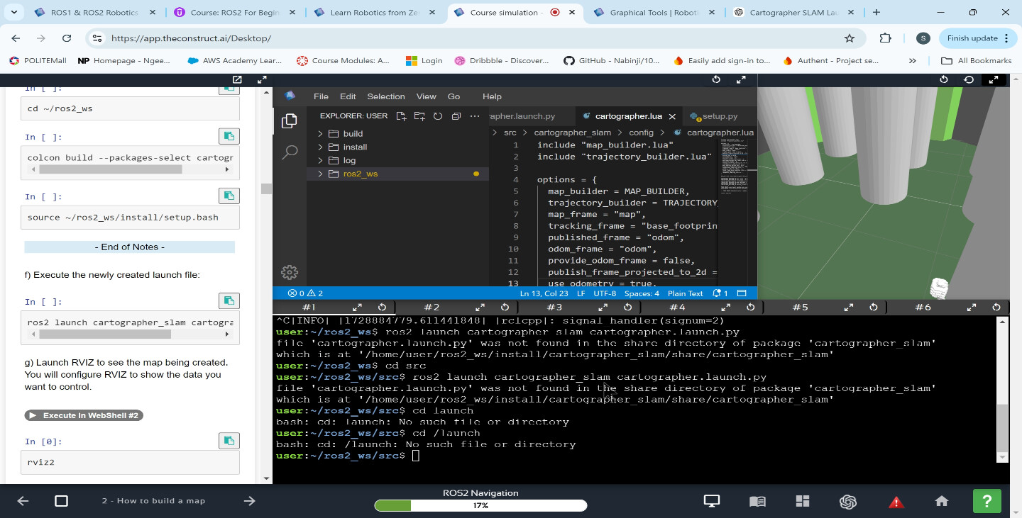

cd is a Linux command to enter a directory, and the directory must exist at the level in which you are running the command.
In your screenshot, your terminal is at ~/ros2_ws/src, so there is no /launch directory there.
Your IDE shows your file structure to be ~/ros2_ws/src/cartographer_slam/launch.
If you want to access that directory from where you are at, then the command would be cd cartographer_slam/launch.
