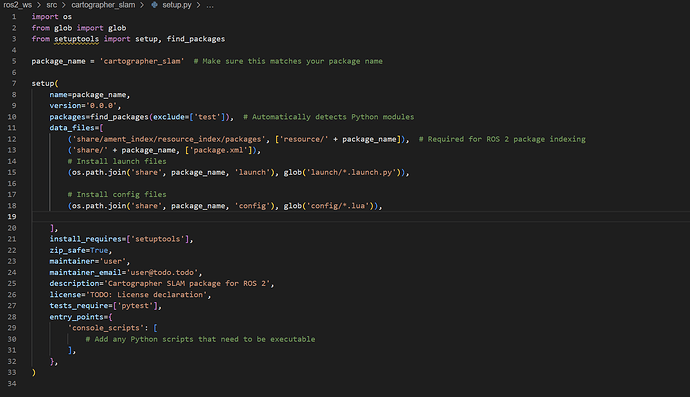

Hi! This is my setup.py
Thanks for your help.

Going through your setup.py file, I don’t find any issues with the file contents. So your setup.py file should work as it is. However, I can suggest one change:
Try replacing the following line in your setup.py file:
packages=find_packages(exclude=['test']),
with the following line:
packages=[package_name],
That could possibly fix your issue, I guess.

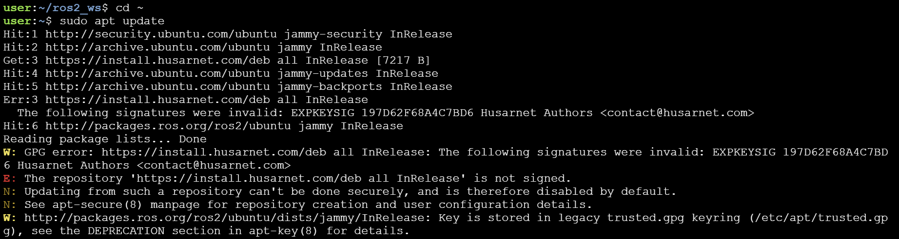

Hello again,
Unfortunately, I just tried it and it did not resolve the issue.
I am not sure if that is related to this when I try to use
sudo apt update
otherwise I still have the same problem. :frowning_face:
Best,
Mariella
Hi @mariellarsanchez ,
I had the same output as you have.
You need to issue the commands one by one, no all together. I am aware that I have grouped two sets of commands, but they need to be executed one-by-one.
Please try executing them separately (within the same terminal, not in different terminals), and then let me know.
I saw the same exact output that you have shown me in the picture, so I can assure you that issuing the commands one after another will work.
Please try and let me know!
