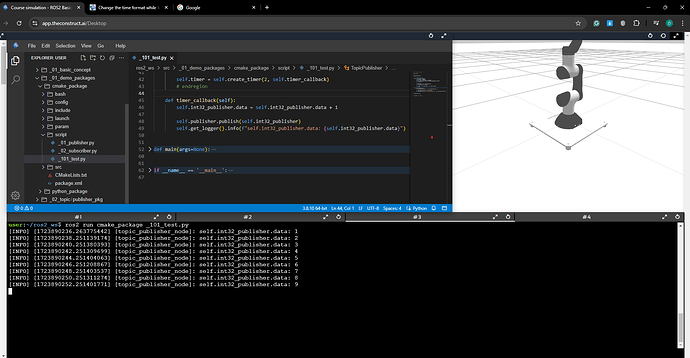

Hi, I was busy so could not come back sooner.
This time I will keep up until the end
I try your suggestion but it does not work.
It still prints the float time.
Could you check my code?

Please check and help
Thanks

If I use the logger from logging library like you said:
logger = logging.getLogger(name)
logger.info(‘This is an info message’)
logger.error(‘An error occurred’)
I can have the message like I want but when I check in RosConsole tool, it does not show these messages. RosConsole just show messages that log by self.get_logger().info.
So I want to keep logging normally but only changing the time format for checking issue easily later
