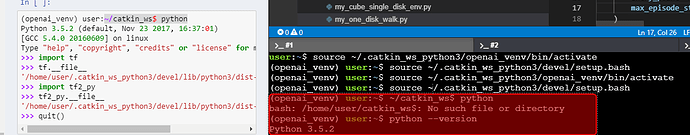

Hi i performed the steps aformentioned however i get the following issue:
I think there is a problem with the Euler library that is compatible with Python 2. Can someone hint me please???

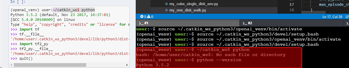

I I followed aforementioned indications to launch the Deepq algoritm in virtual environment (with Python 3):
but still get the error.
Another point i would like to mention is that the jupiternotebook indication doesn t work for me.
I perform the command “python --version”
Any idea about all these points ? What am i doing wrong ???

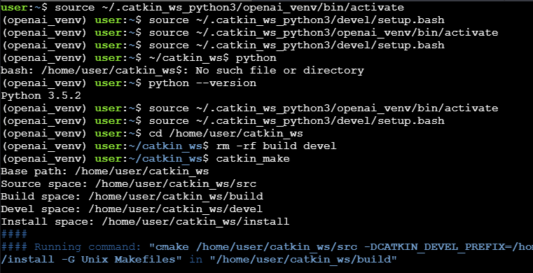

Even doing all the steps when I do catkin_make it still finds python2 as interpreter even if I’m using the virtual environment… any ideas?
Thank you Ricardo, by specifying the version of python I solved my problem.
Actually using your command " catkin_make -DPYTHON_EXECUTABLE:FILEPATH=/home/user/python3_ws/py3env/bin/python" I got the following error “CMake Error at /usr/share/cmake-3.5/Modules/FindPackageHandleStandardArgs.cmake:148 (message):
Could NOT find PythonInterp: Found unsuitable version “1.4”, but required
is at least “2” (found /home/user/python3_ws/py3env/bin/python)”
Instead using this catkin command I was able to compile successfully
“catkin build -DCATKIN_ENABLE_TESTING=0 -DCMAKE_BUILD_TYPE=Release -DPYTHON_VERSION=3.5”
The issue is we must compile tf in python3 env.
Thanks! It works!
