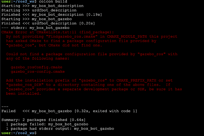

CMake cannot find gazebo_ros while building Gazebo package (Unit 4.30)
I am facing the following error while trying to build the gazebo package.
Following is my CMake file:

Could someone please clarify if there is any additional setup needed or do I need to install anything for it to work?

In the mean time try sourcing the /opt/ros/ distribution , removing the buld folders and retry again. I will see if I can reproduce your issue
I think I fixed it for you , It seems the documentation wasn’t updated for the new Gazebo . I had to install: sudo apt install ros-jazzy-ros-gz, and update the CMakelists.txt and package.xml.
Sorry about the inconvenience, I will see into this issue and resolve it as soon as possible.
It is working as expected now. Thank you. I checked my CMake.Lists and Package.xml and it appears we don’t have to include ‘gazebo_ros’ related lines now.
