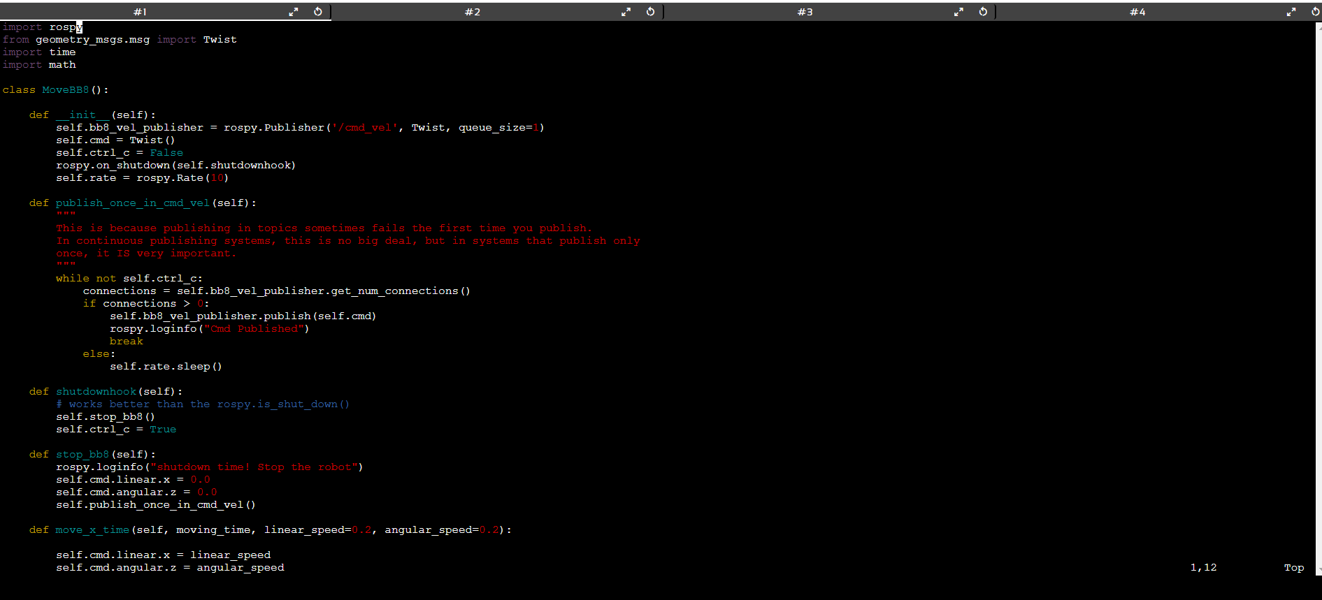

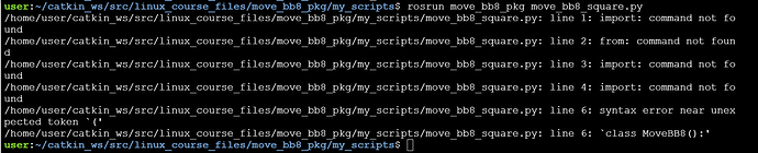

Trying to run the file with all the permission granted but encounter error;

It looks like you’re missing this line at the beginning of your script:
#!/usr/bin/env python
This line is important to let the system know this script should be executed using the Python interpreter. If you add this line at the beginning of your script it should work fine.
