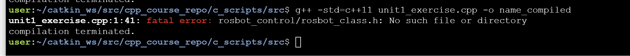

I tried using the code presented in this lesson on how to compile a C++ code file. For some reason, I keep getting an error saying “compilation terminated”. I’m not sure why.
Hello @omarm ,
You are getting the compilation error because the g++ compiler is not able to resolve the dependencies (cannot find rosbot_control.h header file in this case).
For this unit1_exercise.cpp script you should compile it with catkin_make, as indicated in the notebook. With catkin_make, the dependencies are being already handled inside the CMakeLists.txt file.
