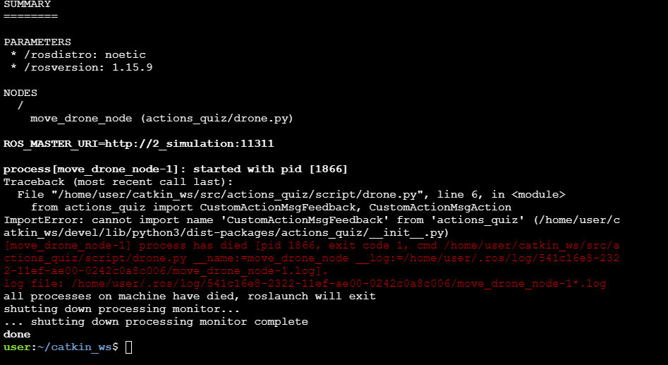

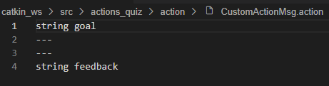

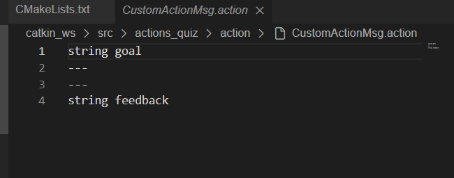

I am trying to create a custom action message and have made all the necessary changes in CMakeLists.txt file. I don’t believe I need to change anything in the package.xml file.
When I try to compile the messages using catkin_make it does not generate any messages. This problem had happened once when creating a custom service message and it fixed when I removed the package and started again, unfortunately it didn’t fix this when I did the same.

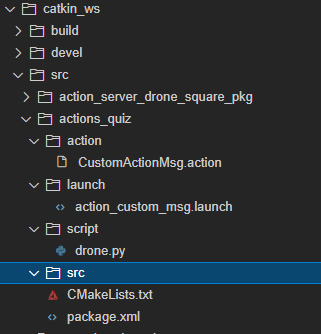

estou com o mesmo problema que o mamojiz97.
Já havia enfrentado esse problema no quiz “services_quiz”, resolvi usando o comando : catkin_make --only-pkg-with-deps services_quiz, porém não consegui compilar as mensagens de Action do “action_quiz”.

O arquivo package.xml:

You have a problem in your python code in the import line.
Tienes un problema en tu código Python en la línea import.
You have specified:
Has especificado:
form actions_quiz import CustomActionMsgFeedback, CustomActionMsgAction
This line is incorrect as CustomActionMsgFeedback cannot be used directly.
Esta línea es incorrecta porque CustomActionMsgFeedback no se puede utilizar directamente.
So replace the above line with the below line and your problem will be solved.
Así que reemplace la línea de arriba con la de abajo y su problema se resolverá.
from actions_quiz.msg import (CustomActionMsgAction,
CustomActionMsgActionFeedback,
CustomActionMsgActionResult)
Let me know if that fixed your issue. I believe it should.
Déjame saber si eso solucionó tu problema. Creo que debería.
