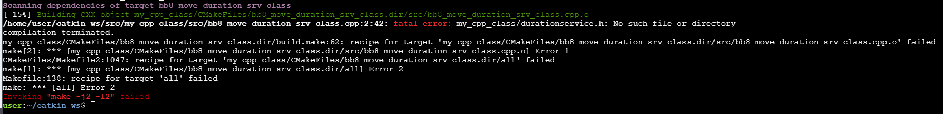

I am experiencing an issue exactly like the one found here, but maybe I can re-explain the steps that led me to the issue. Every package in my workspace can no longer can find header files for any of my custom service messages.
I was able to compile and run my packages, I logged off and when I came back I encountered this error:
/home/user/catkin_ws/src/my_cpp_class/src/bb8_move_duration_srv_class.cpp:2:42: fatal error: my_cpp_class/durationservice.h: No such file or directory
The package that is causing error was not a package I was working on at the time. If I delete this package and try catkin make, then the next package with custom service messages raises this same error.

I tried this and I couldn’t get past the make step, same error.
Please post the exact error you are seeing now. It might be another reason or just that your CMakeLists.txt and/or pacakage.xml is/are not properly setup.
@bayodesegun
@rmmilner
You are trying to import a message from another package my_cpp_class. Please take note of the following:
  1. To do this, you needed to have added my_cpp_class as a dependency when creating the package, i.e. catkin_create_pkg your_package_name roscpp my_cpp_class other_dependencies.
  2. For the Services Quiz (and other quizzes), you should create the custom message within the quiz package itself rather than import it from another package. Yeah, we know about code reuse but just want to keep things simple for the automatic grader. Also, you get to practise creating a custom message again :wink:.
Please adjust your package and let us know how it goes.

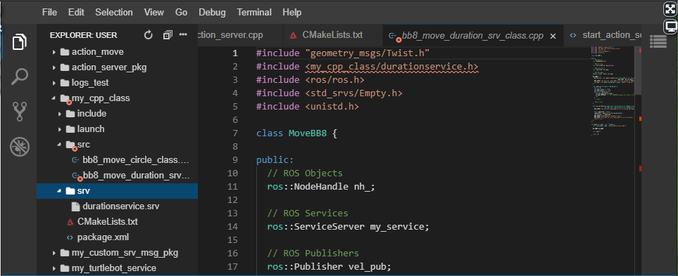

Maybe I am misunderstanding but the service was created in the package that I am using it in.
Oh, I see.
Did you follow the guide for preparing CMakeLists.txt and package.xml? From the CMakeLists.txt you shared, I can see the following are missing:
  • std_msgs is missing in find_package. And do you really need geometry_msgs for building your custom message?
  • catkin_package is empty? Why?
  • Did you edit package.xml as indicated?
I suggest that you carefully review the section about creating custom service messages in the notebook (section titled How to Prepare CMakeLists.txt and package.xml for Custom Service Compilation in Unit Understanding ROS Services - Server), carefully make needed changes and then let us know if you still have problems.
