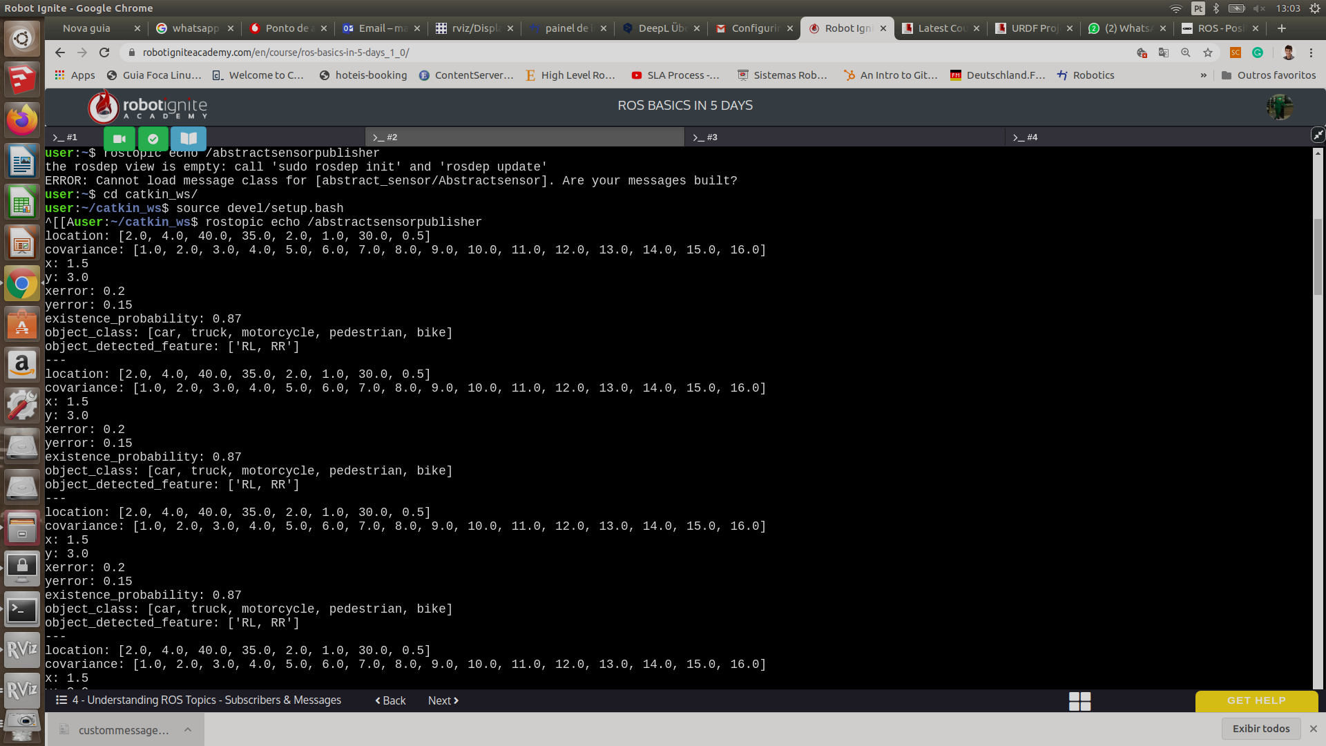

I have created the message which receives these values and tested with a publisher…assigning values…The rostopic echo of this topic is below:
So the question is… If I have for example Radar, camera or whatever be the sensor amount and the type of it…they always will give me information with the features displayed on the screen above. And my question is.
