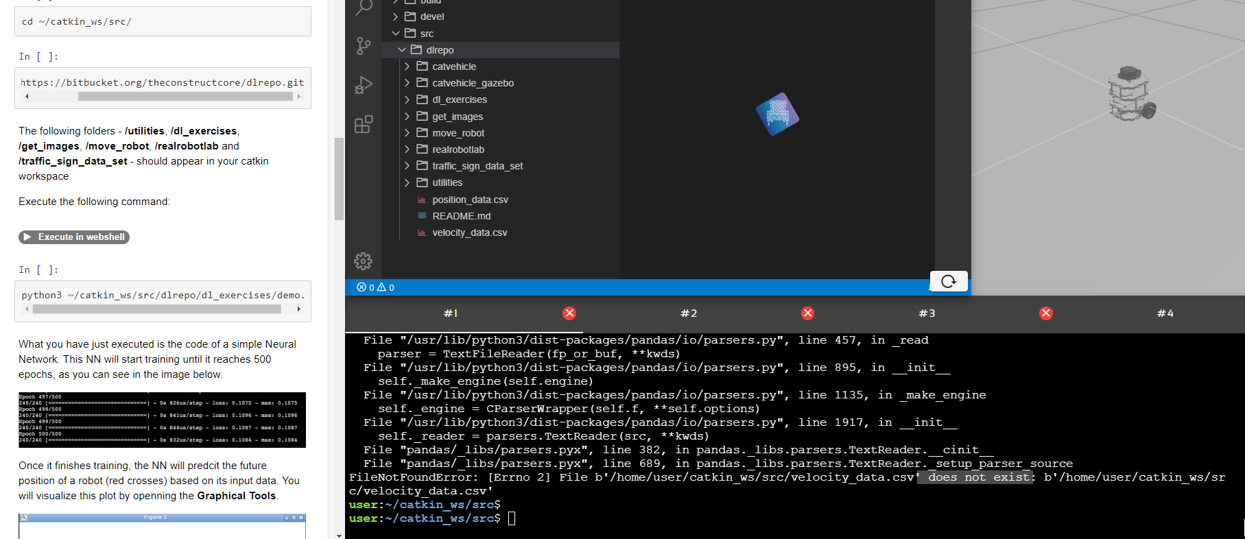

I tired to copy paste the first 3 lines of code in Unit 1, yet it says that the velocity_data.csv file is missing. Does anyone know what I can do to fix this?
For some unknown reason, the content of the ~/catkin_ws/src/dlrepo/dl_exercises/demo.py file contains an error in the path specified to reach the csv file.
Please open that file and change line number 8 by the following:
data = pd.read_csv('~/catkin_ws/src/dlrepo/velocity_data.csv',sep=',',header=0)
That should work. We are going to correct that error in the repo, for future students
