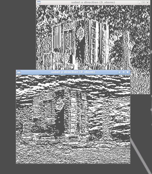

But I use the same statement and get the controdictory results. My code is:
import cv2
import numpy as np
from sensor_msgs.msg import Image
from cv_bridge import CvBridge, CvBridgeError
class Sobela_Class():
        self.img = cv2.imread(
            '/home/user/catkin_ws/src/opencv_for_robotics_images/Unit_2/Course_images/test_img_b.jpg')
        self.img = cv2.resize(self.img, (450, 350))
        self.img = cv2.cvtColor(self.img, cv2.COLOR_BGR2GRAY)
    def main(self):
        # sobel operation along with horizontal direction
        self.sobel_x = cv2.Sobel(self.img, cv2.CV_64F, 1, 0, ksize=3)
        # sobel operation along with vertical direction
        self.sobel_y = cv2.Sobel(self.img, cv2.CV_64F, 0, 1, ksize=3)
        # show images
        cv2.imshow('original image', self.img)
        cv2.imshow('sobel_x', self.sobel_x)
        cv2.imshow('sobel_y', self.sobel_y)
        cv2.waitKey(0)
        cv2.destroyAllWindows()
    rospy.init_node("sobela_1_node")
    sobela = Sobela_Class()
    sobela.main()
and results are:
I think there may be a mistake. I am new beginner of OpenCV, but I guess there is similarity in OpenCV and Numpy. For example, the representation of 2D array is defined as [y,x], y for so-called colume, x for so-called row. So maybe here sobel_x = cv2.Sobel(img, cv2.CV_64F, 1, 0, ksize=3) is actually for vertical direction and sobel_x = cv2.Sobel(img, cv2.CV_64F, 0, 1, ksize=3) for horizontal direction.
Please let me know if I am wrong.

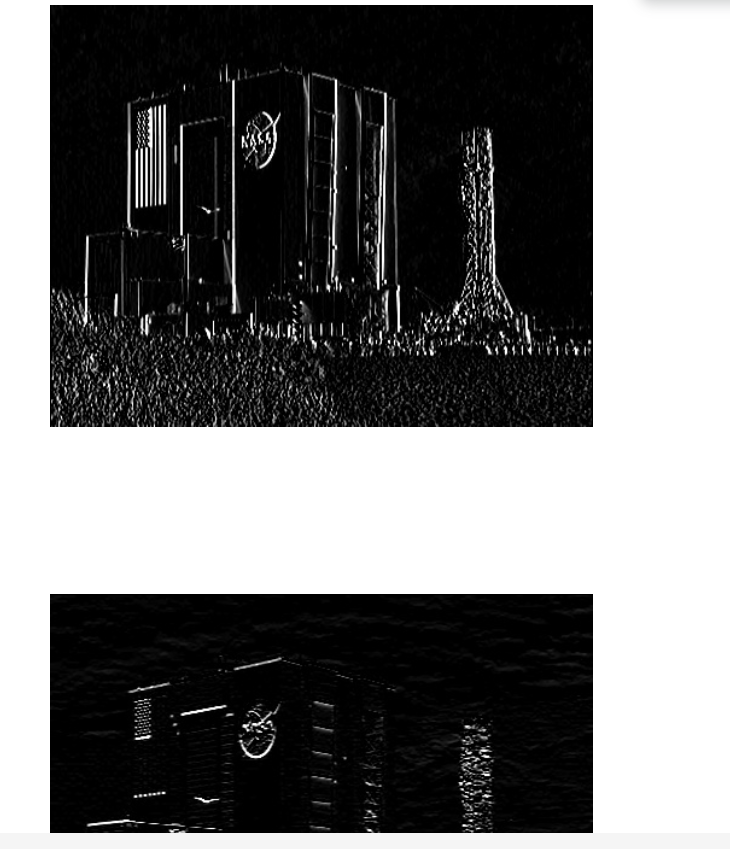

Hi @MeineLiebeAxt ,
I am quite familiar with OpenCV because I have worked on edge-detection projects.
Yes, Sobel operation on X axis gives you vertical lines and Sobel operation on Y axis gives you horizontal lines.
The images in the tutorial’s notebook must be swapped. Those are wrong at the moment.
Thank you @girishkumar.kannan for confirmation!
Hello @MeineLiebeAxt @girishkumar.kannan ,
I’ve just fixed the order of the images in the notebook. Thanks for the feedback!

I still the same image as of 2025.
This is what is mentioned in the notebook while what I am getting by sobel operator is this one:
