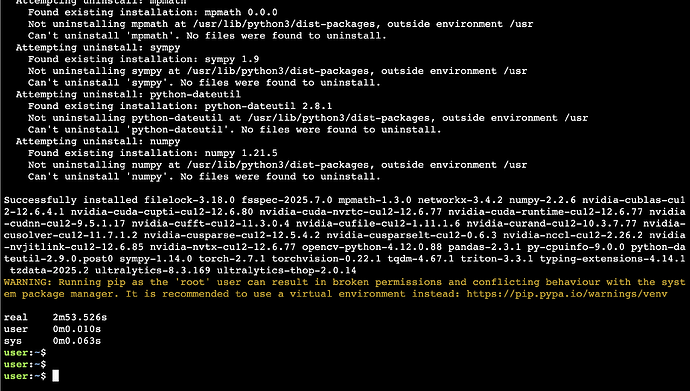

I’m not following the same class, but I had a similar issue and managed to fix it by downgrading NumPy. You can try running:
pip install "numpy<2"
@frabbit, please let us know if you were able to resolve this issue or if you still need help.
i have this problem now:
user:~$ ros2 run advanced_perception yolo_pose_estimation_node
WARNING ⚠️ user config directory '/home/user/.config/Ultralytics' is not writeable, defaulting to '/tmp' or CWD.Alternatively you can define a YOLO_CONFIG_DIR environment variable for this path.
Creating new Ultralytics Settings v0.0.6 file ✅
View Ultralytics Settings with 'yolo settings' or at '/tmp/Ultralytics/settings.json'
Update Settings with 'yolo settings key=value', i.e. 'yolo settings runs_dir=path/to/dir'. For help see https://docs.ultralytics.com/quickstart/#ultralytics-settings.

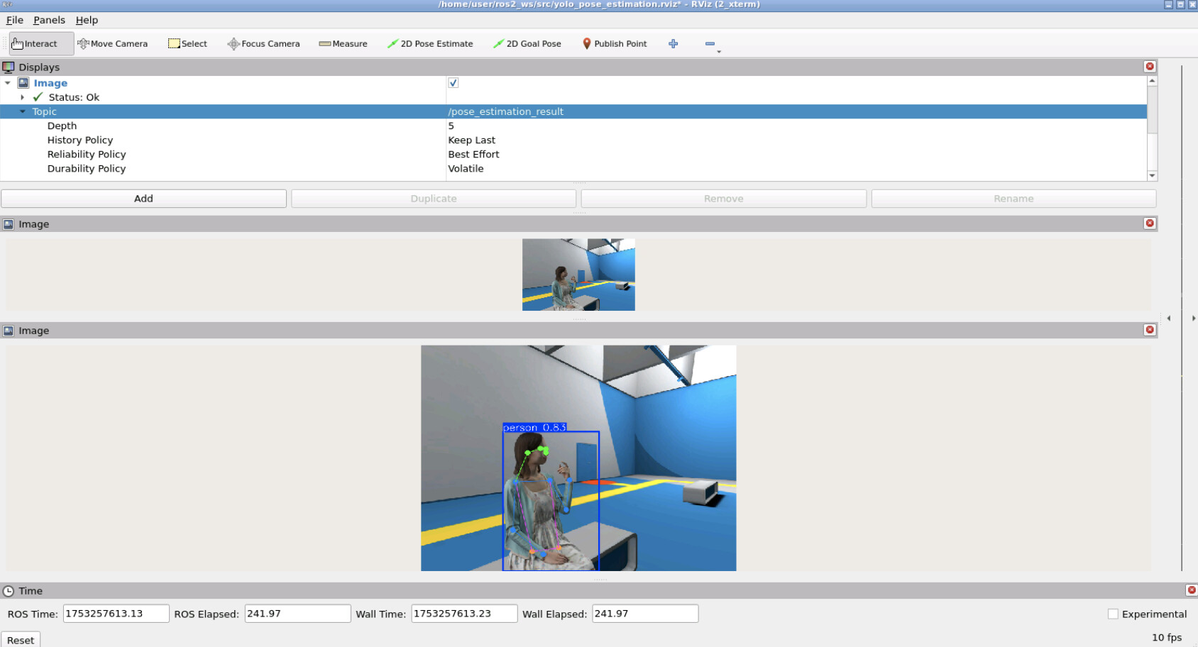

View Ultralytics Settings with 'yolo settings' or at '/home/user/.config/Ultralytics/settings.json'
0: 480x640 (no detections), 2869.1ms
Speed: 22.4ms preprocess, 2869.1ms inference, 9.6ms postprocess per image at shape (1, 3, 480, 640)

When I open a shell, the auto_install.sh script starts automatically and there are some errors… i dont know if this is the problem
Installing collected packages: py-cpuinfo, nvidia-cusparselt-cu12, mpmath, tzdata, typing-extensions, triton, tqdm, sympy, python-dateutil, nvidia-nvtx-cu12, nvidia-nvjitlink-cu12, nvidia-nccl-cu12, nvidia-curand-cu12, nvidia-cufile-cu12, nvidia-cuda-runtime-cu12, nvidia-cuda-nvrtc-cu12, nvidia-cuda-cupti-cu12, nvidia-cublas-cu12, numpy, networkx, fsspec, filelock, pandas, opencv-python, nvidia-cusparse-cu12, nvidia-cufft-cu12, nvidia-cudnn-cu12, nvidia-cusolver-cu12, torch, ultralytics-thop, torchvision, ultralytics
  Attempting uninstall: mpmath
    Found existing installation: mpmath 0.0.0
    Not uninstalling mpmath at /usr/lib/python3/dist-packages, outside environment /usr
    Can't uninstall 'mpmath'. No files were found to uninstall.
  Attempting uninstall: sympy
    Found existing installation: sympy 1.9
    Not uninstalling sympy at /usr/lib/python3/dist-packages, outside environment /usr
    Can't uninstall 'sympy'. No files were found to uninstall.
  Attempting uninstall: python-dateutil
    Found existing installation: python-dateutil 2.8.1
    Not uninstalling python-dateutil at /usr/lib/python3/dist-packages, outside environment /usr
    Can't uninstall 'python-dateutil'. No files were found to uninstall.
  Attempting uninstall: numpy
    Found existing installation: numpy 1.21.5
    Not uninstalling numpy at /usr/lib/python3/dist-packages, outside environment /usr
    Can't uninstall 'numpy'. No files were found to uninstall.
echo "Setup unitree ros2 environment"
source /opt/ros/foxy/setup.bash
source /home/unitree/unitree_ros2/cyclonedds_ws/install/setup.bash
export RMW_IMPLEMENTATION=rmw_cyclonedds_cpp
export CYCLONEDDS_URI=/home/unitree/unitree_ros2/cyclonedds_ws/src/cyclonedds_reply.xml
export LD_LIBRARY_PATH=/usr/local/lib:$LD_LIBRARY_PATH
export LD_LIBRARY_PATH=/home/unitree/graph_pid_ws/install/tasknode/lib/tasknode:/home/unitree/graph_pid_ws/src/depends:$LD_LIBRARY_PATH
export PYTHONPATH=$PYTHONPATH:/home/unitree/unitree_ros2/install/imu/lib/imu
cd /home/unitree/unitree_ros2/
colcon build
source install/setup.bashSuccessfully installed filelock-3.18.0 fsspec-2025.7.0 mpmath-1.3.0 networkx-3.4.2 numpy-2.2.6 nvidia-cublas-cu12-12.6.4.1 nvidia-cuda-cupti-cu12-12.6.80 nvidia-cuda-nvrtc-cu12-12.6.77 nvidia-cuda-runtime-cu12-12.6.77 nvidia-cudnn-cu12-9.5.1.17 nvidia-cufft-cu12-11.3.0.4 nvidia-cufile-cu12-1.11.1.6nvidia-curand-cu12-10.3.7.77 nvidia-cusolver-cu12-11.7.1.2 nvidia-cusparse-cu12-12.5.4.2 nvidia-cusparselt-cu12-0.6.3 nvidia-nccl-cu12-2.26.2 nvidia-nvjitlink-cu12-12.6.85 nvidia-nvtx-cu12-12.6.77 opencv-python-4.12.0.88 pandas-2.3.1 py-cpuinfo-9.0.0 python-dateutil-2.9.0.post0 sympy-1.14.0 torch-2.7.1 torchvision-0.22.1 tqdm-4.67.1 triton-3.3.1 typing-extensions-4.14.1 tzdata-2025.2 ultralytics-8.3.167 ultralytics-thop-2.0.14
Anyway, I open another terminal to launch the simulation, and I don’t know if this is normal, but it shows me this:

user:~/ros2_ws$ pip install "numpy<2"
Defaulting to user installation because normal site-packages is not writeable
Collecting numpy<2
  Downloading numpy-1.26.4-cp310-cp310-manylinux_2_17_x86_64.manylinux2014_x86_64.whl (18.2 MB)
     ━━━━━━━━━━━━━━━━━━━━━━━━━━━━━━━━━ 18.2/18.2 MB 26.3 MB/s eta 0:00:00
Installing collected packages: numpy
  WARNING: The script f2py is installed in '/home/user/.local/bin' whichis not on PATH.
  Consider adding this directory to PATH or, if you prefer to suppress this warning, use --no-warn-script-location.
ERROR: pip's dependency resolver does not currently take into account all the packages that are installed. This behaviour is the source of the following dependency conflicts.
opencv-python 4.12.0.88 requires numpy<2.3.0,>=2; python_version >= "3.9", but you have numpy 1.26.4 which is incompatible.
Successfully installed numpy-1.26.4
There is a conflict with python 3.9… what can i do?

Hello @frabbit ,
Let me try to answer everything:
  1. About the auto_install.sh messages, they’re ok. I just tested it and in the end, everything required gets installed:
  1. About the simulation error message you shared, you can also ignore it a as the simulation starts properly.
  2. About the pip install "numpy<2" command, this is necessary. Don’t worry about the conflict message, as the correct version of numpy is installed: Successfully installed numpy-1.26.4
  3. Finally, to properly test the pose estimation node, make sure to move the robot close to the person for a proper detection. I just tested these steps, and it works fine:
Hope this helps,
