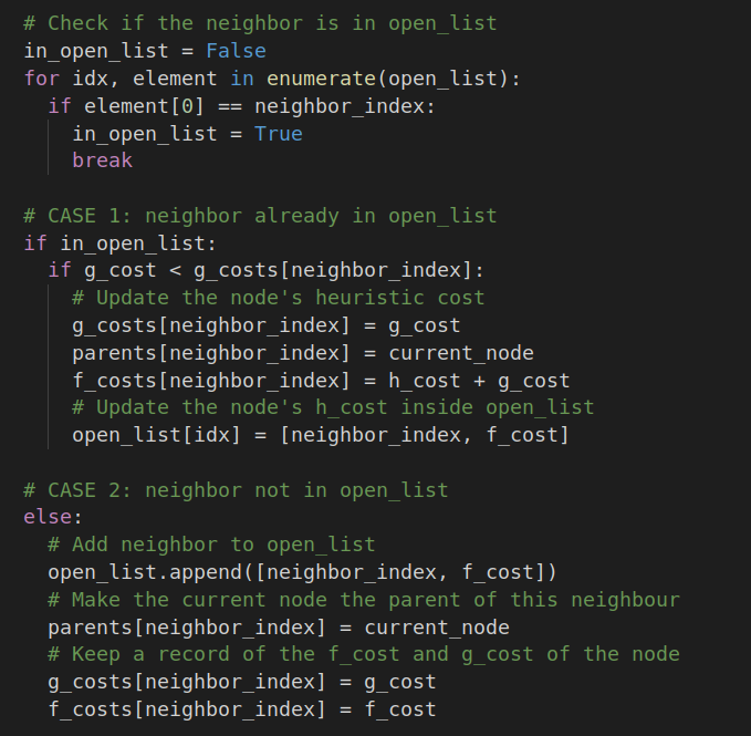

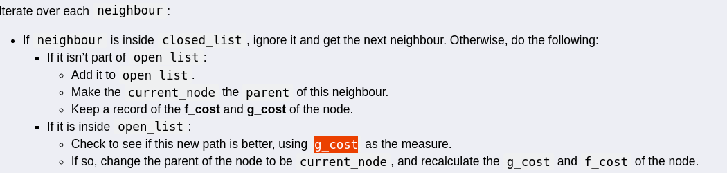

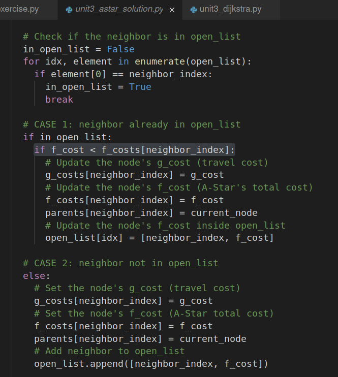

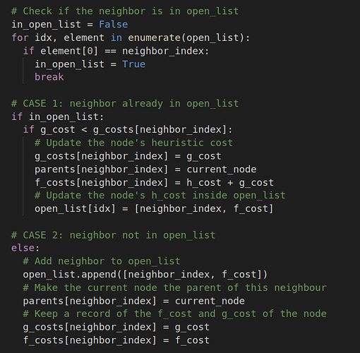

4 - During implementation of A* Star algorithm there are different instructions to be done, regarding code to neighbours already checked and found inside open_list previously:
The my code changed from the solution a little bit:
My_code:
Solution:
Although there was a conceptual difference between my code and the solution. The resul was the same using rviz and the robot navigated with success even in concave region, finding the best short path. Is my code “incomplete”, I mean in same specific situation using just g_cost to comparion in that specific block would cause a sub-optimal behaviour or other issue? What is the correct instruction, use the g_cost or f_cost in open_list block of code?

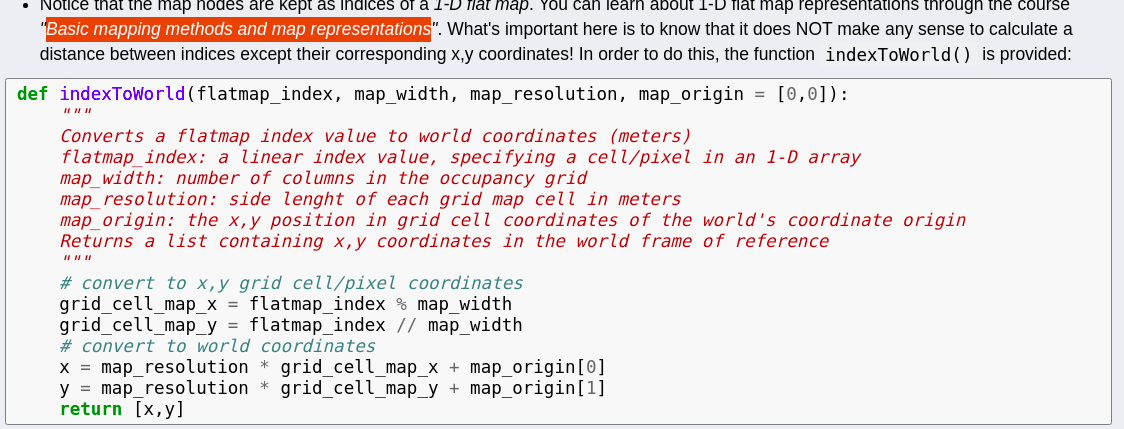

5- I did not understand completely the grid to world frame conversion, especially why for x_map there is a modulus operator and for y_map the floor division operator was used.
You suggested to read the course Basic mapping methods and map representations to learn in more detail. Is a RIA course? where is located please? I tried to find in search icon without success.
