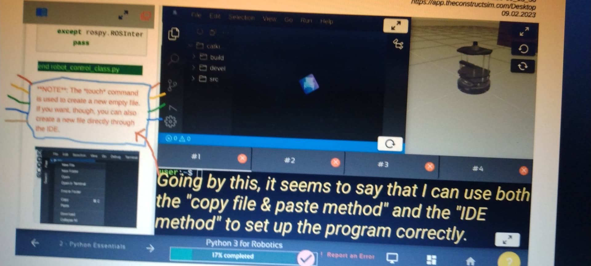

So what you’re saying is, don’t copy, paste & execute the first five files (“cd ~/catkin_ws/src/” - through - “touch robot_control_class.py”) into shell #1 but instead, use the IDE method to set up the program correctly.
If this is the case, It would have been a lot better for everybody if you would have just told people to do that in the first place.
However, going by this
it seems to say I can use both methods to set up the program correctly. This is what I was going by.
Hi @allens,
We use the touch command to create new empty file(s) from the command line. Alternatively, if you prefer to use the IDE (the code editor) you can right click on a folder and create a new empty file by selecting the “New File” option in the context menu.
For adding code to an empty file we use the IDE (code editor).
So after the file creation, you should see the new filenames inside in the IDE’s left sidebar file browser.
To add code to a new file you have to first open a file.
To open a file in your IDE you just have to click the file name in the IDE’s left sidebar file browser using your mouse. When you click on a file it opens in a new tab inside the IDE main area. Notice that the tab is displaying the filename. Observe that each time you click a different file name it will open inside the IDE main area.
To copy code from the lectures you can click on the ‘copy code to clipboard’ button at the top of each code block (or alternatively select the code you want and press Ctrl+C to copy.)
To paste code open the file where you want to add the code using the IDE. Make sure you can write text: the cursor should be blinking off and on, and then press Ctrl+V to paste.
I have now added detailed instructions on how to add code from the lectures to files to help future students.
Cheers,
Roberto
