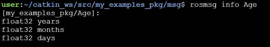

The msg Age is working fine but when I am trying to import it the python script it’s giving me an error. The CMakeList.txt and Package.xml files are also the same as the solution given. Please help me out with this!

Check if the message exists, using
rosmsg list | grep Age
Also, Can you include the following info:
  • the python code you are running
  • the SRV file
  • the package XML file
  • the cmake file
  • the error message as its appearing
Copy paste the code using the image from
This will give me more info to work with. (Make sure that you have compiled using Cmake and sourced the work after, since most of the errors are caused because of this.)

  1. can you confirm that the Age.msg file exist in a folder called msg in the package my_examples_pkg?
2.Share the following outputs:
rosmsg info Age
  1. Share the following’s output:
rospack list | grep my_examples_pkg
4.Also try running the python program after running the following command (this updates the package list)
rospack profile
  1. image
