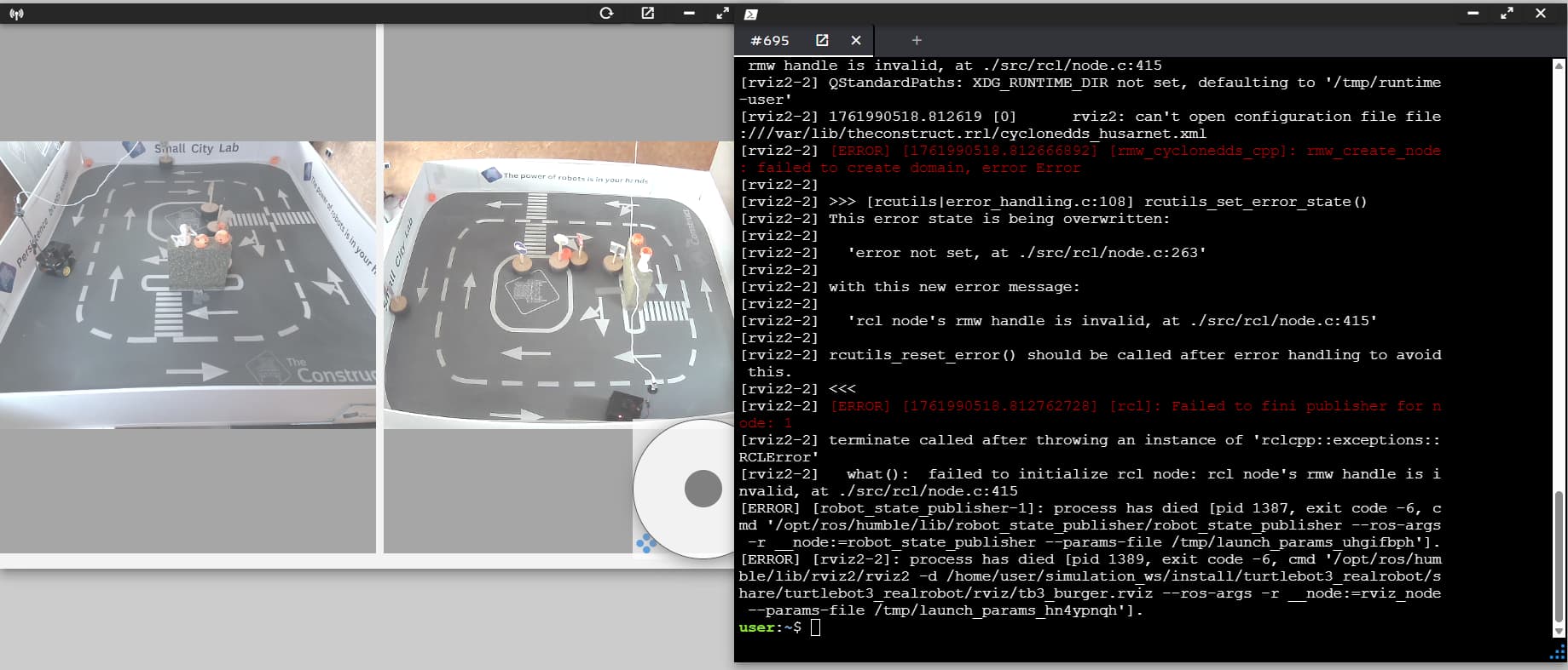

Now, I’m facing a new problem when I try to launch the Real Robot bringup program.
Command :
source ~/simulation_ws/install/setup.bash
ros2 launch turtlebot3_realrobot main_turtlebot3_lab.launch.xml
When I execute the launch command, I immediately get the following error logs:
I have already tried the following steps:
  • Closed and relaunched the Real Robot Lab
  • Reloaded the environment
  • Restarted the entire ROSject
  • Verified that I’m using the Real Robot Lab (not the simulation)
Could you please check the Real Robot Lab connection or reset my Real Robot environment?
Thanks a lot for your help and support!

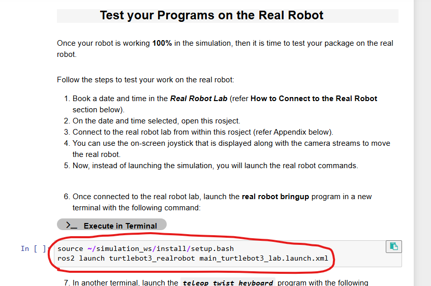

I would like to confirm the correct procedure when working with the Real Robot Lab,
since I have been strictly following the instructions provided in the Jupyter notebook.
According to the current Jupyter guide under “Test your Programs on the Real Robot”,
the first step after connecting to the Real Robot Lab is to run:
However, based on your explanation, it seems that this step might only apply to the simulation and not to the real robot.
Could you please confirm whether this part of the Jupyter notebook might be outdated or contain an error?
It would be very helpful to know the exact first step to take after connecting to the Real Robot Lab —
for example, whether I should instead run:
Then execute :
./robot_interface.py
and directly execute my bash control scripts (./obstacle_avoider.bash).
I just want to ensure I’m following the correct procedure before testing again.
Thank you very much for your time and clarification!
