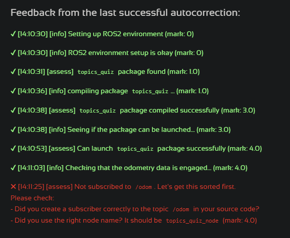

I checked everything including the name of the files. here is the feedback for my third submission -
but weirdly I had passed this check on my second submission (scored 8/10) as described in my post.

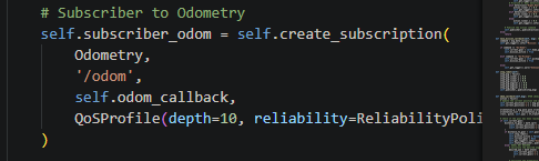

btw, here is the part of script where i am initializing the odom subscriber -

here is image snippet of my code. I have not used ‘odom_bridge’ anywhere in the code.

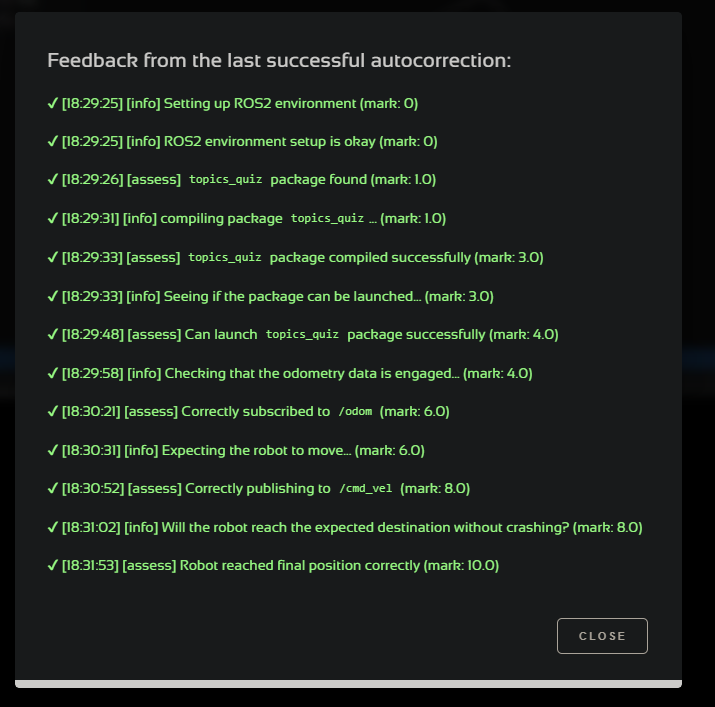

I fixed the issue and completed the assesment -
Could you please let us know how you fixed it?
I had to reset the simulaiton world and all terminals. I also removed colcon cache and killed all ros2 processes.
started it all again and submitted my quiz.
