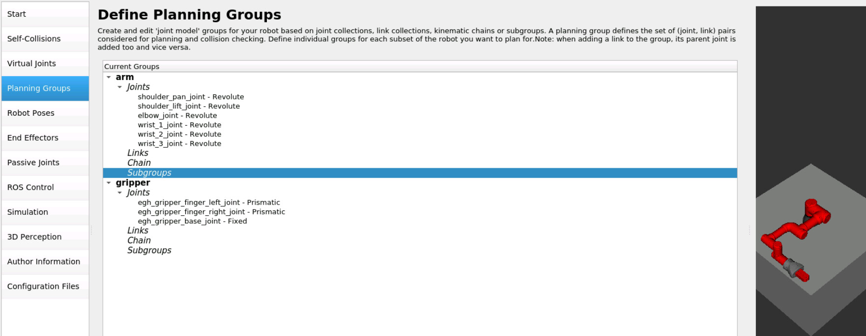

My planning groups are as follows

Hello @Ryan_Disco ,
